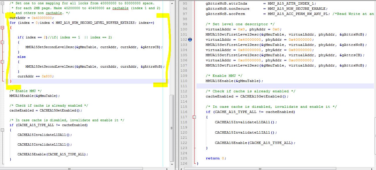

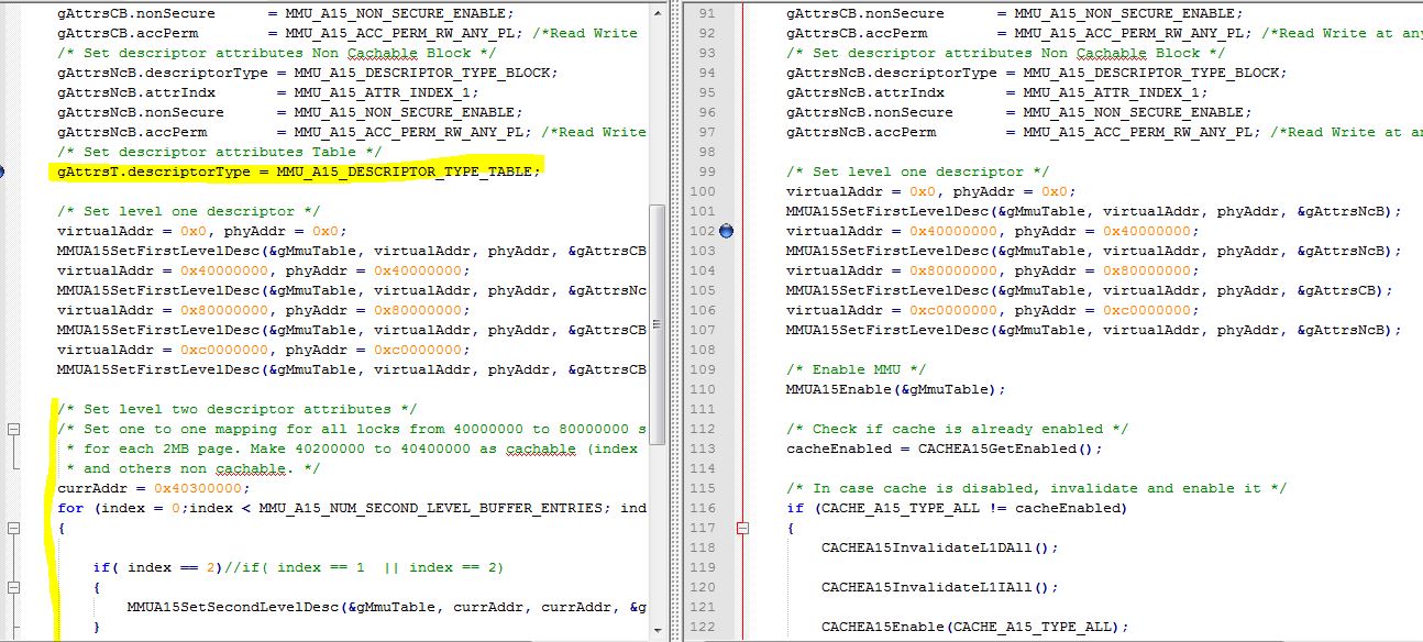

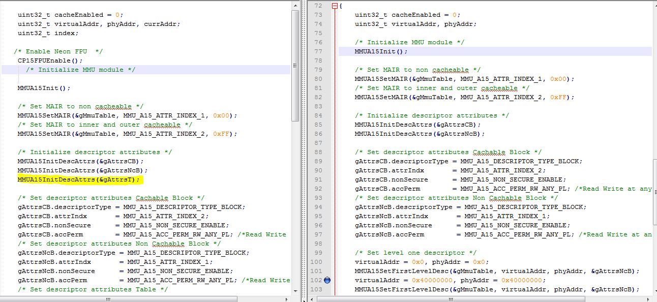

       Hi Rishabh,
    I have attached the screenshots of the snippets used in CAN driver built for OCMC and CAN driver built for DDR respectively, with respect to Cache memory.
    There were some changes observed in the cache code shared by you and the code built for DDR .
    I have highlighted them in the attachment.
    After including these differences in code running on OCMC, we observe the cache code getting executed without creating any exception.
    This works both in debug and QSPI boot mode.
    Can you please tell me what these differences are ?
    What can be the impact of the same?
    Is the code on the left side in the image correct ? - this seems functional
    How can we verify exactly that cache is enabled correctly ?
    We want to enable cache only for CAN.
    How can we ensure or check whether cache is enabled for entire bootloader or only CAN?
    Shivanand
  • Hi Shivanand,
    I have answered your questions below:
    Cache cannot be enabled for a peripheral. Cache is enabled for a memory region. The second level descriptors have size of 2 MB and hence cache can be enabled for minimum 2 MB region. E.g. 0x4000_0000 to 0x4020_0000.
    OCMC_RAM1 start address is 0x4030_0000 and size is 512 KB and hence cache will be enabled for full 0x4020_0000 to 0x4040_0000 region.
    The code on left side is same as the one you had shared earlier. I had specified the below issues previously as well:
    1. For 0x4000_0000 region you are setting first level descriptor as block and this means second level descriptor is not needed. Defining second level descriptor won't have any effect.
    2. The size of second level descriptor is 2 MB so you can't start from 0x4030_0000.
    To summarize the cache is not enabled for OCMC in the code on the left hand side.
    I would suggest you to go through chapter "B3.6 Long-descriptor translation table format" of the ARM documentation static.docs.arm.com/.../DDI0406C_C_arm_architecture_reference_manual.pdf.
    Rishabh

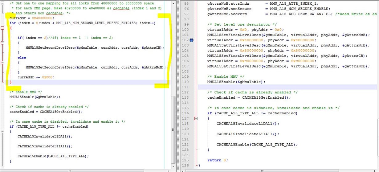

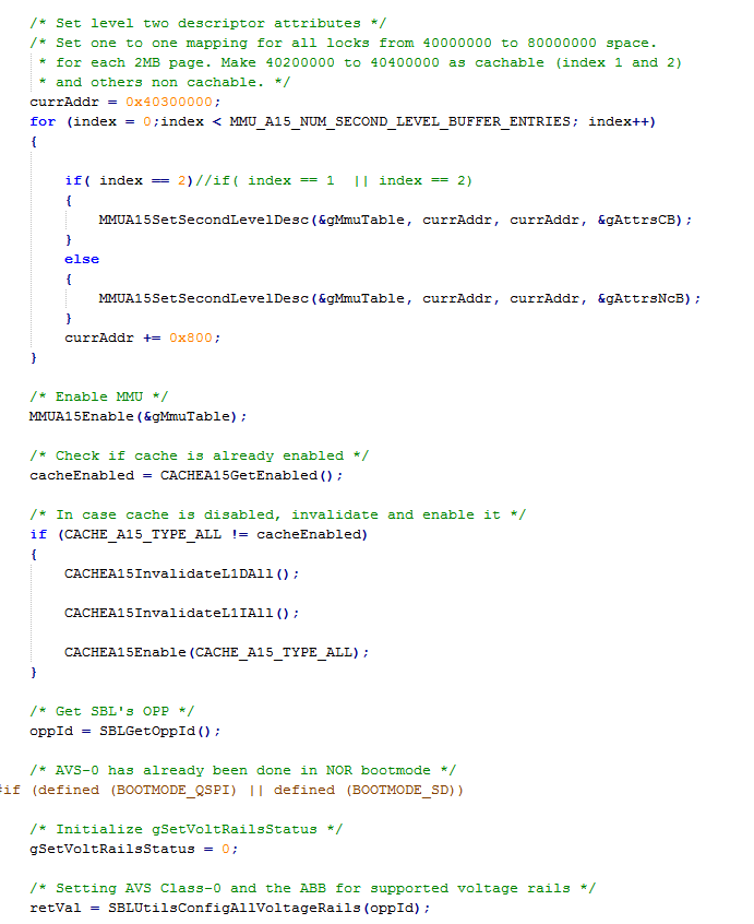

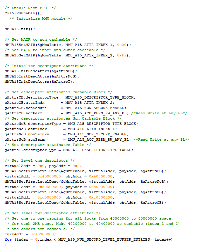

  • Hi Rishabh,
    A correction in what I had mentioned in previous post.
    The code on right hand side is what is configured right now and seems to be functional as the API timing has reduced.
    Can you please answer the below questions wrt to right hand side snippet:
    Is the right hand side configuration correct?
    Shivanand
  • Hi Shivanand,
    The code on right hand side enables cache for DDR memory region.
    Cache is not enabled for OCMC.
    You can use API CACHEA15GetEnabled to see whether cache is enabled or not.
    Rishabh
  • Hi Rishabh,
    What modifications needs to be done in the Right side code to enable cache for OCMC RAM .

    I had already share the modified code previously (the one on 22nd Dec). The code on left hand side is the one which has changes made on top of original code shared by me.
    Prasad has scheduled a remote debug to resolve this issue quickly. Can you check the mail.
