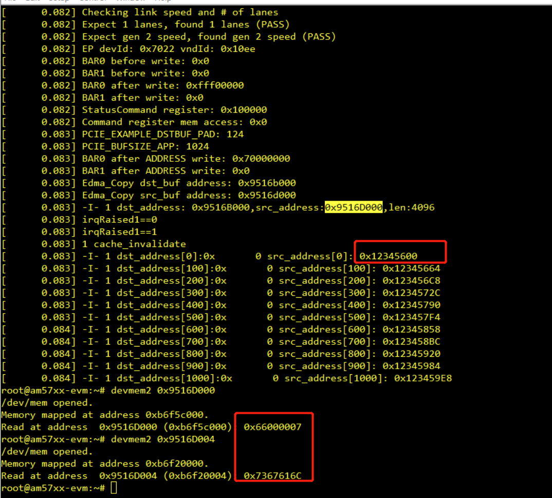

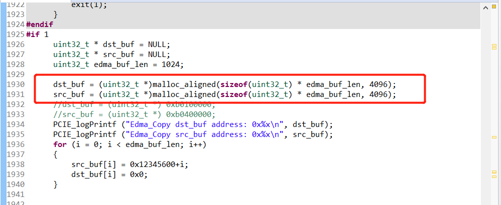

TI, I am using the PCIE_idkAM572x_wSoCFile_C66BiosExampleProject demo, and I malloc the memory for a buffer,then I init the buffer. When I run it on the linux, I use the devmem2 + address to read the buffer,and  I find the value is not same as the value that I init.

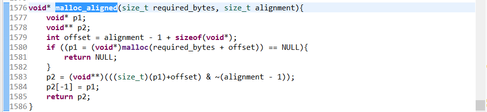

the malloc_aligned function:
