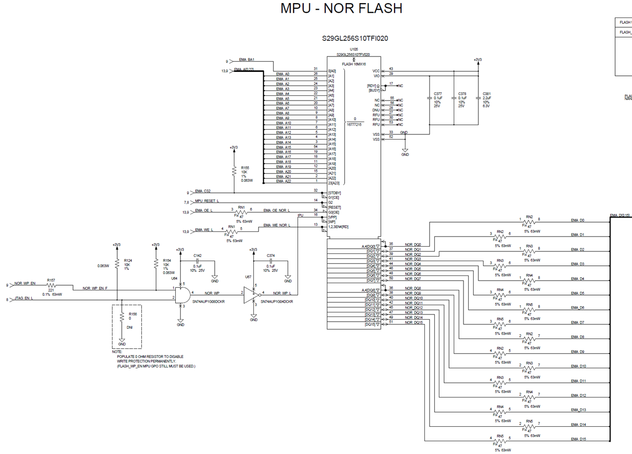

Hello TI team,
I am working on Linux device driver updates/customization for our custom board based on OMAP-L138. I have CS2 32MB NOR (16bit S29GL256S) and CS3 1GB NAND (8bit MT29F8G08ABABAWP) connected via AEMIF. I am booting from NOR using direct NOR boot and do not have NAND set via uBoot. Once I have enabled MTD + NAND drivers in Linux kernel (4.9.10). I set everything using http://processors.wiki.ti.com/index.php/Linux_Core_NAND_User's_Guide
I believe I have Pinmux set correctly:
nand_pins: nand_pins {
pinctrl-single,bits = <
/* EMA_WAIT[0], EMA_OE, EMA_WE, EMA_CS[3] */
0x1c 0x10110010 0xf0ff00f0
* EMA_D[0], EMA_D[1], EMA_D[2],
* EMA_D[3], EMA_D[4], EMA_D[5],
* EMA_D[6], EMA_D[7]
0x24 0x11111111 0xffffffff
/* EMA_A[1], EMA_A[2] */
0x30 0x01100000 0x0ff00000
/* NAND_WP - GPIO06_10 */
0x34 0x00800000 0x00f00000

NOR works correctly. Unfortunately, when I enabled MTD+NAND, I am getting Linux crash during booting. Crash occurs in davinci_nand.c->nand_davinci_hwcontrol->iowrite8(cmd, nand->IO_ADDR_W); Its seems that CS3 address (0x6200000) data, reallocated to virtual address (In my case to 0xc8a00000) is not accessible and when I read/write to this location kernel immediately crashes. I was suspecting PSC for AEMIF, but it seems to be always enabled and running (I tried PLL0_SYSCLK3 settings in range from 25MHz to 100MHz). My question is, is there any way to disable/enable particular CS? Or ensure is it running? What could actually leads to situation I am able to access 0x68000000 (AEMIF Control registers), when whenever I touch 0x62000000 I got immediately crash. Could this be even HW wiring problem? Could this be caused that uBoot sets the AEMIF during the uBoot and during Linux kernel boot I want to access/setup the NAND access?
If you need any other information, let me know.
Michal
Wiring is following:
