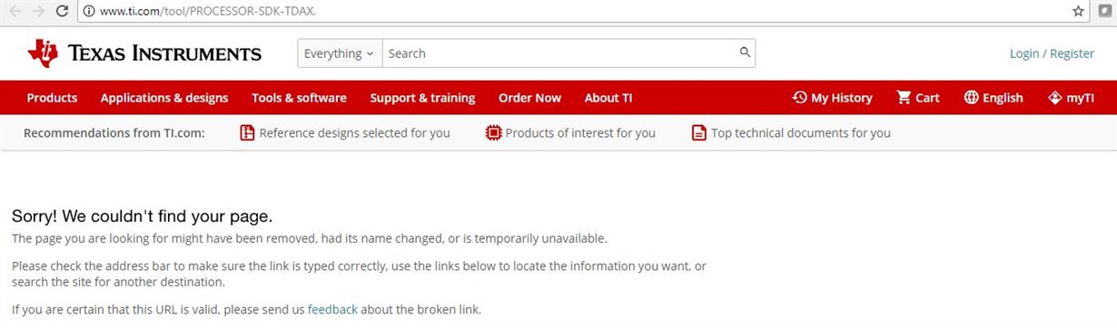

  • Hi Rishabh,
    I can not access above link. Please find below screen shot.
    I am referring section 2.2 Linux Installation from VisionSDK_UserGuide_TDA2Ex.pdf
    I have referred subsections 2.2.1 PC Requirements, 2.2.2 Software Requirements, We are not referring section 2.2.2.1 A15 Compiler, Linker, as we do not need A15 compiler.
    Here we do not get any information what is a setup file to install Vision SDK or compiler ti-cgt-arm_16.9.4.LTS on Linux 64 bit machine.
    Request you to provide setup file for same.
    Kanchan
  • Hi Kanchan,
    "." got added to the hyperlink. Anyway here is the link again: www.ti.com/tool/PROCESSOR-SDK-TDAX
    You should look at VisionSDK_Linux_UserGuide.pdf for installation steps.
    Rishabh
