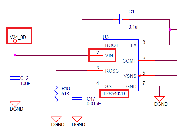

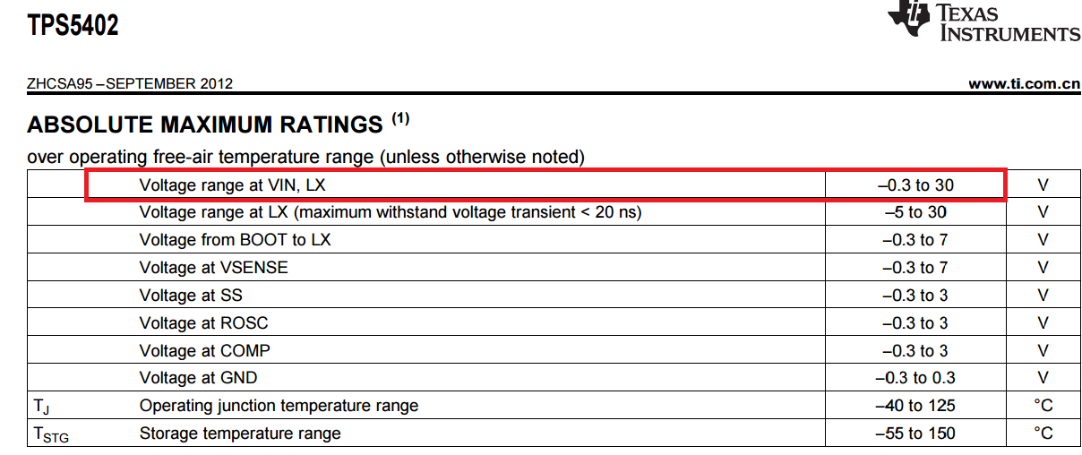

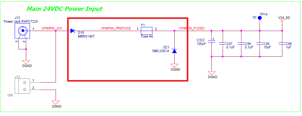

I am going to start my design reference to AM437x' IDK. Its Power input shows as below:

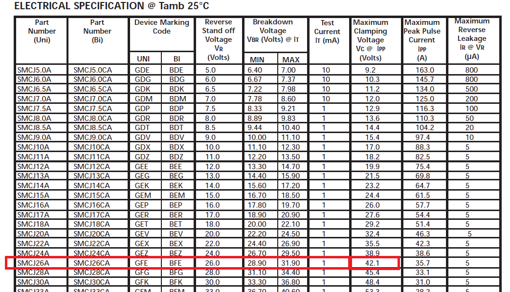

I am not clear about the function of MBRS104T, Fuse4A and SMCJ26CA. I need advise on componet selection for these. Thanks !

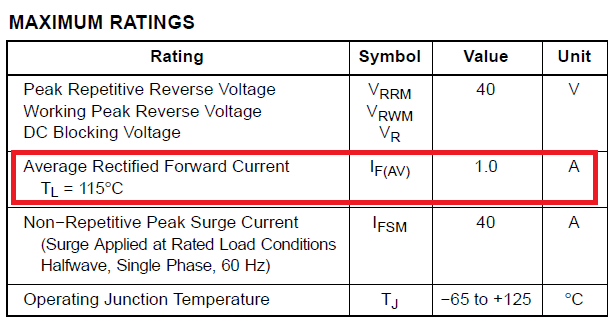

Hi, Biser:
The MBRS140T 's forward current is only 1A instead of 4A. The attachment is the datasheet.
