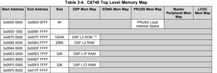

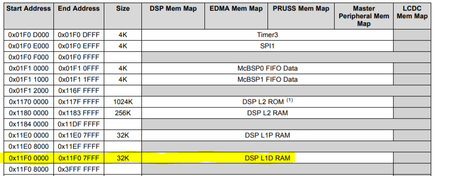

  • Hi Shalini,
    I think your source address may be the issue. Looking at the memory map table, the EDMA does not have access to this address space.
    The EDMA can only access DSP L1D RAM using the global address range starting at 0x11F00000:
    So I believe you need to change your source address to 0x11f00300.
    Thank you a lot that solved my issue.
    With Regards
    Shalini
