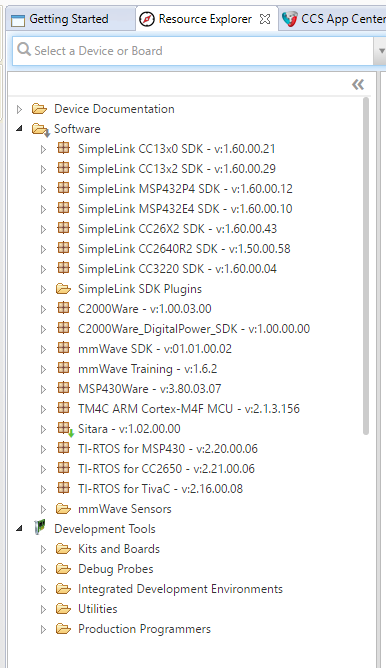

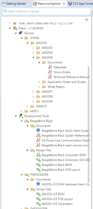

Hi.
I'm trying to use TI RTOS at Beaglebone black.
I have installed below and ran the CCS and I'm referring "processors.wiki.ti.com/.../Processor_SDK_RTOS_Software_Developer_Guide"
- ccs_setup_7.3.0.00019.exe
- ti-processor-sdk-rtos-am335x-evm-04.02.00.09-Windows-x86-Install
I'm trying to open "Simple examples with an operating system -> http://processors.wiki.ti.com/index.php/Processor_SDK_RTOS_Examples"
and I have installed software packages which are relates with Sitara includes SYS/BIOS.
I'm not sure what I missed so could someone help what I'm missing?
Louie,
Please see processors.wiki.ti.com/.../Rebuilding_The_PDK and this helpful video training.ti.com/processor-sdk-device-drivers-setup-test
This is the best mechanism to generate examples for the SDK.
You may also want to bookmark this FAQ processors.wiki.ti.com/.../Processor_SDK_RTOS_FAQ which has some useful details.
Hope this helps.
Lali
