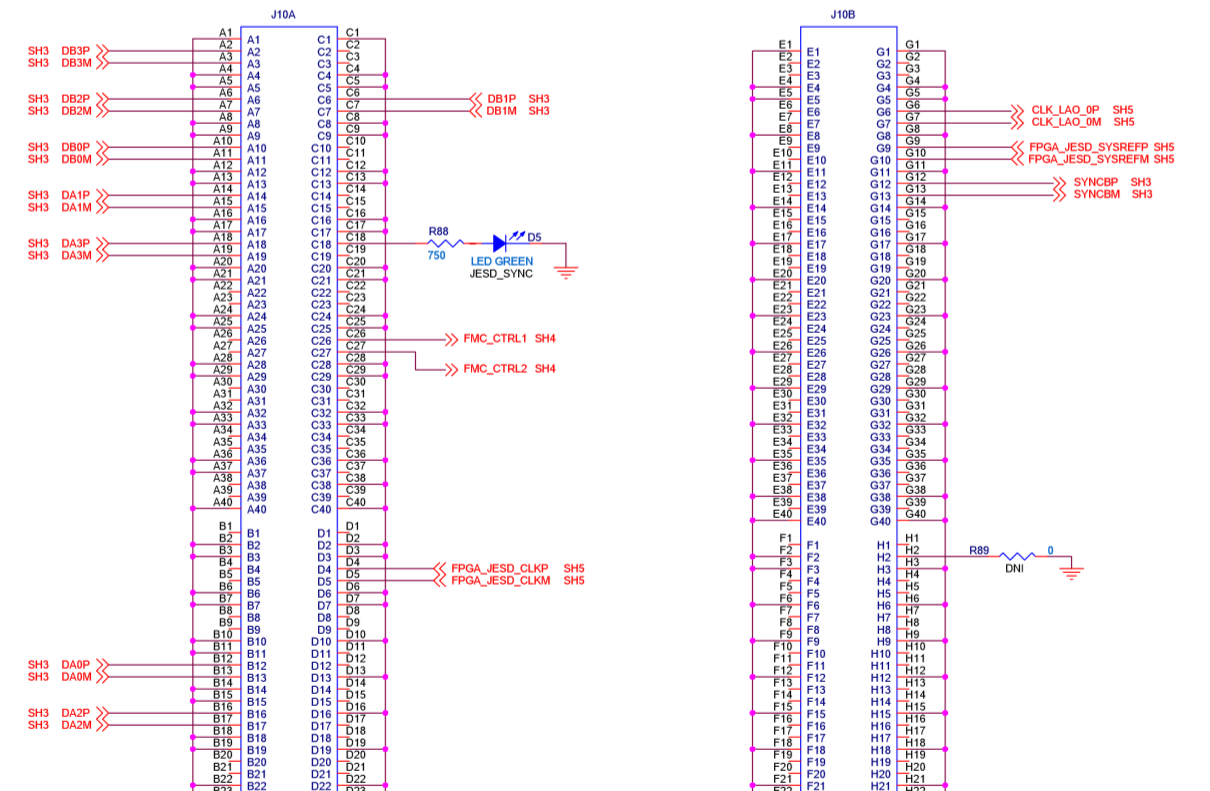

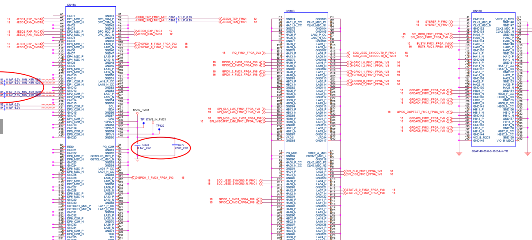

I have read some post from e2e community.I have purchased the 66ak2l06 EVM and the ADC32RF80 EVM.I want connect this two card using the FMC with the jesd204b interface working correctly.I don't have softdevelopment now.By these FMC shcematic diagram I find that the clock pin constraint not the same.
The jesd_clk ,jesd_ref and jesd_sysc signal constraint can't be matched.I think if there are not the DLC maybe,the jesd204b interface can't work correctly.Also ,the ADC14X250EVM FMCclock pin is the same with the AD32RF80.Therefore ,I think this adc can not communicate with 66ak evm without DLC.I want to ask whether my inference above all is right.Secondly I want to now how can I get the K2L-HSP DLC,which is the same with the TIDEP0081 design. At last ,I want to ask the difference between the TCI6630K2L and the 66AK2L06.My board is TCIEVMK2LX EVM V1.0.3.0 because of the heat sink on the chip,I don't know the chip model.therefore I have the third question. I am looking forward to your reply very much .I am sorry for my English ,thank you.
