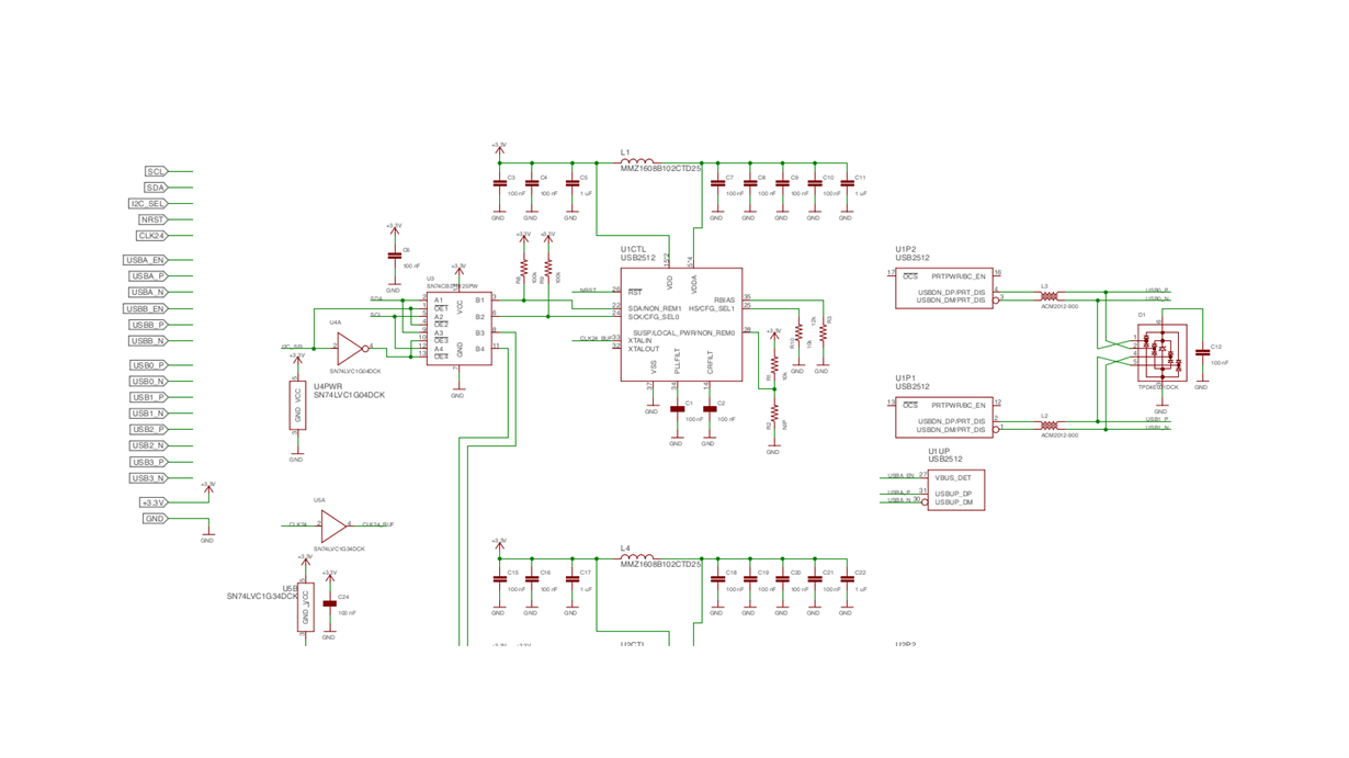

Using SDK version 4.02.00.09. We have a custom board with AM3358 Soc and USB hub chip USB2512 connected to USB0 port but it doesn't seem to be detected at all. In fact, I don't believe the drivers, particularly the musb_hdrc, are not loading and configuring properly since there are no port related entries entries under /sys/bus/platform/musb_hdrc to be able to read status as per similar issue discussed in e2e.ti.com/.../333490:

The USB2512 chip that is connected to USB0 is properly powered and configured over I2C. Yet when programmed and the usb drivers loaded, it is not detected and enumerated at all.
  • Roman,
    Please post your USB portion of the schematics.

    This doesn't look right, I don't see musb-dsps driver here.
    And the device tree setting you provided seems missing enabling cppi41dma node, please refer to am335x-evm.dts.
    Please also run the following script on your board, it would give more diagnosis information.

    Schematics sections:
    Processor side:
    Hub side:
  • The usb driver configuration seems good, I think the issue is in the hardware design. But I don't understand your schematic, what is the USB1 block on the processor side? and the USBSW0/1/2/3 blocks? I'd like to see the whole USB routes between AM335x USB0 and the hub. By the way, the resolution of the hub portion is too small, I barely can read anything.
  • Let me check with client what I can provide you with in terms of the schematics. I cannot post it online.
    With that said though, I still should be able to read the musb_hdrc status as well as other info in /sys/bus/platform regardless of the schematics, shouldn't I?
  • Roman,
    I sent you a TI e2e friendship request, please accept it then you can email me the schematics, if you cannot post it online.
