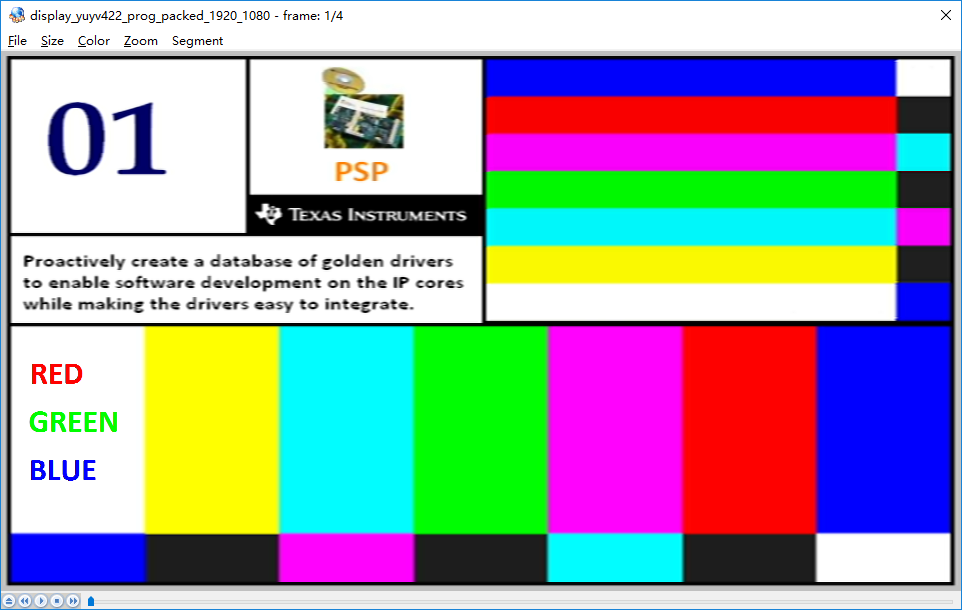

    The input data is "pdk_01_08_00_16\packages\ti\drv\vps\docs\test_inputs\dss_input_files\display_yuyv422_prog_packed_1920_1080.tigf", which is 1080P.

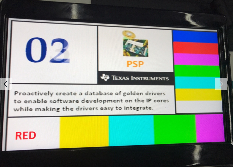

    And in the DisplayDss_main.h, i change the related parameters to " standard FVID2_STD_720P_60","inWidth 1280", "inHeight 720".
    The display result is as follows:
     And the correct result should be:
     So, we can see that the display result on my LCD is just about 2/3 of the correct result.
     The input data is 1080P, but my output configuration is 720P as my serializer can only support up to 720P. I think this may be the reason of above abnormal display.
     So i think i need to scale the input from 1080P to 720P firstly, then i can display it correctly.

  • Hi xuanbo,
    First the input image itself is 1920x1080 and when you use it for 720p display, display example picks up 1280x720 top-left portion of the input image and displays it since your input width and height are set to 1280x720.
    If you want to display full image, then you need to set inWidth and inHeight to 1920x1080 and enable the scalar as Rishabh mentioned.

  • Minor correction. It should be other way
    dssPrms.inFmt.width = 1920
    dssPrms.inFmt.height = 1080
    dssPrms.tarWidth = 1280
    dssPrms.tarHeight = 720
    In fact the DSS application already supports this without any modification in the app code - all are exposed in the test params. Instead of setting the in width/height as below
                /* inWidth */
                DISP_APP_USE_LCD_WIDTH,
                /* inHeight */
                DISP_APP_USE_LCD_HEIGHT,
    Set to
                /* inWidth */
                1920,
                /* inHeight */
                1080

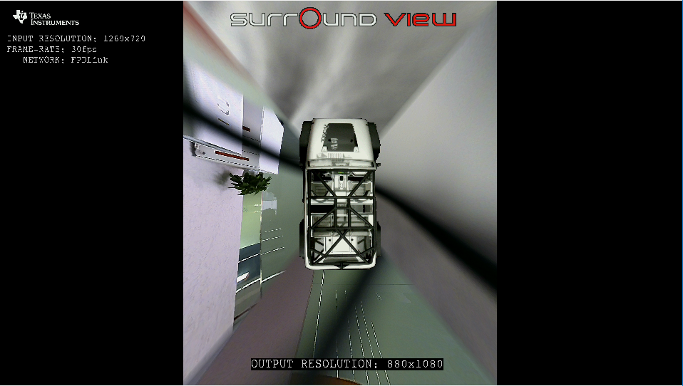

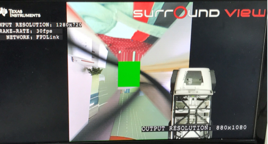

         I have another question about pipeline scalar:
         As i know, the graphic pipeline does not support scale. For the usecase "csi2_cal_sv_standalone", if the display device support 1080P, the correct display should be like this:
        But for my display device, which support up to 720P, i made the scale for the video1 pipeline by the method above. The display result is like this:
        From the result, i think the data come from video1 pipeline has been scaled correctly to adapt to my LCD.
        But the graphic elements such as Jeep image and text are not scaled as graphic pipeline does not support scale.
        Although i can modify the GrpxSrcLink_drawSurroundViewStandaloneLayout ( grpxSrcLink_svStandalone_layout.c ) to move the graphic elements postiion, but i think it is not a good way. For example, Jeep image's position can be changed, but Jeep image's size can not be changed.(As you see ,the current Jeep image is a little too large for my LCD)
       So, what should i do to adapt the display result to my LCD perfectly?
    xuanbo

  • Hi xuanbo,
    Unfortunately, we dont have grpx scalar. May be you could offline scalar graphics image using some PC tools and then can use it.
    Rgds,
