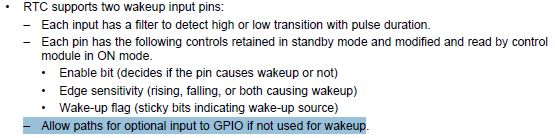

In the "AM57xx Schematic Checklist" I see that if one wants to use RTC timer functional, Wakeup0 and Wakeup3 needs to pulldown to VSS. At the moment I can't see any reasons to do so.
We want use Wakup0 and Wakeup3 als GPIO. Will we face any functional limitation to RTC timer when not pulling down this two pins to VSS?
Thanks and best regards,
