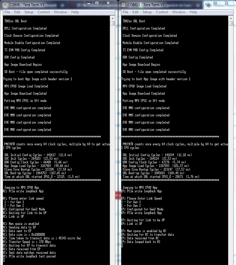

The test in its current state, without any modifications states that the PCIe throughput is 370 MBps when both RC and EP utilize Gen2 transfer speed.

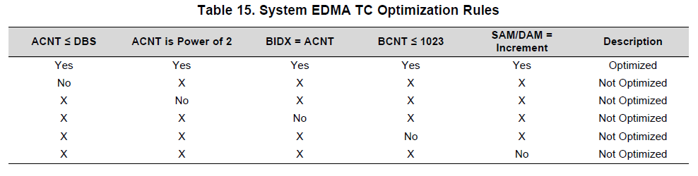

1) The EDMA transfer parameters are to be set so that the transfer controller submits the least possible number of transfer requests
2) The EDMA TC default burst size is to be equal to the PCIe payload size
As for the bullet 1), I referred to this table (found in SPRAC21).
In the test, the system EDMA's TC0 is used. I have used EDMA before so I was able to experiment with the (A/B/C)CNT values. For example, the original test which has ACNT=16K, BCNT=16M/16K and CCNT=1 (which do not comply to the table above) gives 370 MBps for throughput. When I set the values to ACNT=128, BCNT=128 and CCNT=1024 (which is recommended in the table) I get 330 MBps which is worse. What else should I try regarding the transfer parameters only?

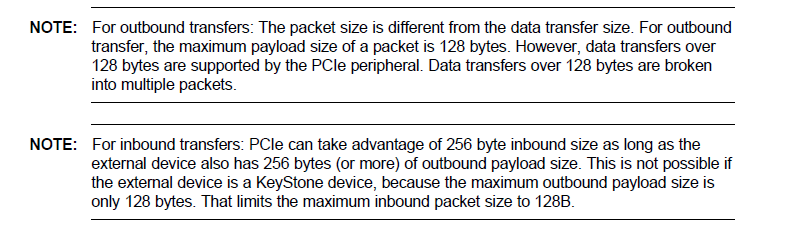

- I cannot confirm that the EDMA's TC0 is indeed using DBS of 128B which I found to be defined in "<PROCESSOR_SDK_ROOT>\ti_components\drivers\pdk_01_08_00_16\packages\ti\csl\soc\tda2xx\hw_ctrl_core.h" CTRL_CORE_CONTROL_IO_1_TC0_DEFAULT_BURST_SIZE_MASK macro definition. It is not used anywhere and I don't know where to find the code that configures the TC's.
- When we say PCIe payload size, does that mean it is the size of the data being sent in a TLP excluding the headers that are added to it? Also, where can I set the payload size of PCIe's transfers? I suppose that it can be 128B at best which I concluded from this snippet found in SPRABK5B. Both of my devices are KeyStone aren't they (they are TDA2xx)?

    The burst size is 128 bytes. Anyway this can be configured by modifying CTRL_CORE_CONTROL_IO_1 register.
    TDA2xx has two PCIe lanes. You can modify PCIE_NUMBER_OF_LANES to 2 to increase the PCIe throughput.
    On TDA2xx max PCIe payload size is 256 bytes which is set upon reset (register PCIECTRL_RC_DBICS_DEV_CAP).

    I had discussions regarding EDMA configuration. It seems that EDMA configuration is the most optimal.
    Only optimization possible is having the buffer 128 byte aligned.
    Rishabh

    I just installed clean PROCESSOR_SDK_VISION_03_02_00_00, did a clean build of the pdk drivers, sbl and examples. I only changed the NUMBER_OF_LANES macro definition to 2 in pcie_app.h, nothing else. Still no success, it says that throughput is 370MBps.
    Here's the console output from both cores below:
    I have no idea what could be the problem.
    Nick
