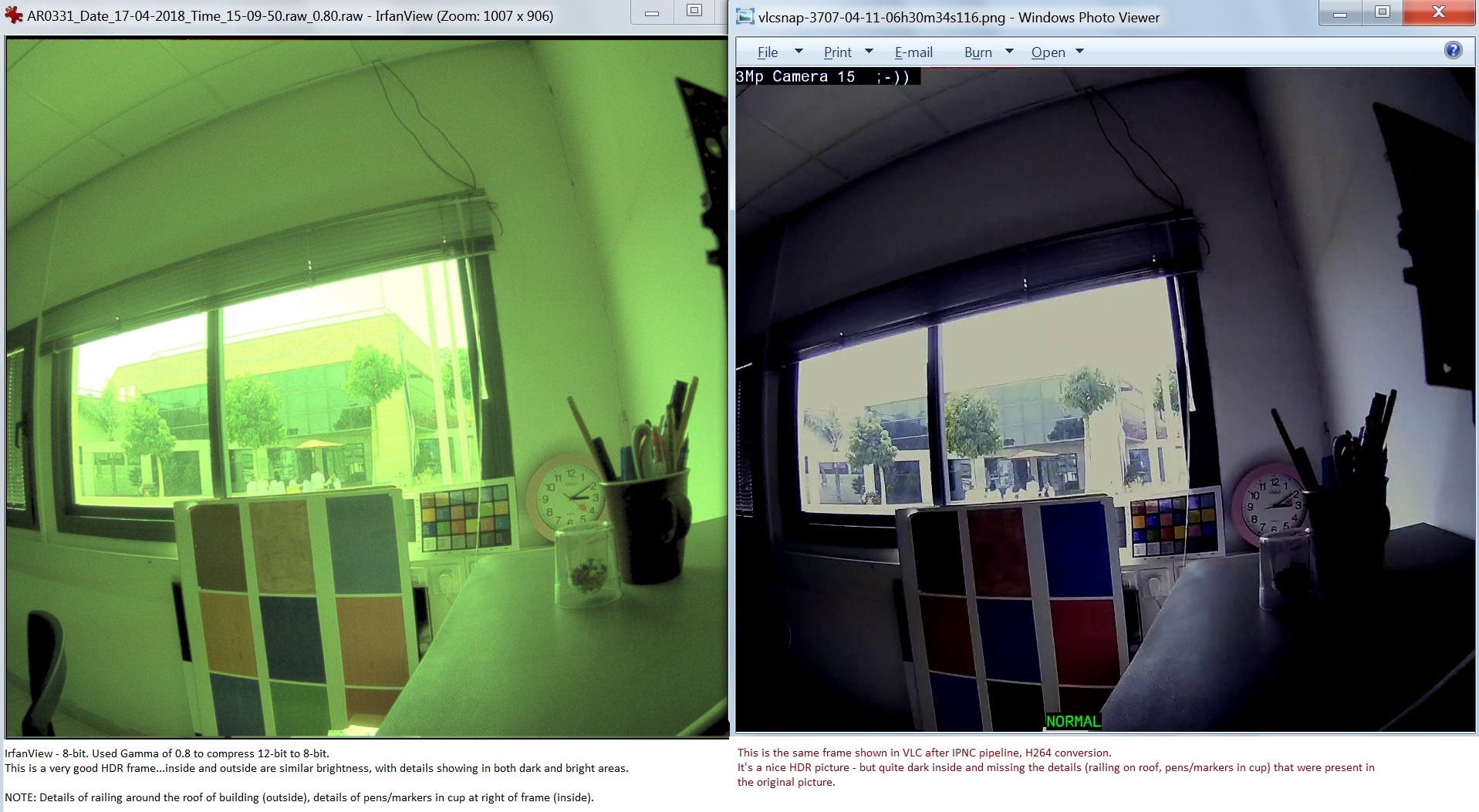

  • The RAW 12-bit picture (compressed with gamma = 1.0) to 8-bit shows perfect color. This frame is exactly what is output from the sensor before the CameraLink.
    The H264 picture received at the end of all the IPNC links is shown as the RTSP streaming.
    Why are the colors so changed? I can see all of the DCC register settings in the DCC tuning program - but I haven't figured out how to download them to a file in order to post here.
    ALTM pedestal is set to 0xA8 (168) and i left the DCC settings as default.
    BTW, is there a special set of DCC settings for the AR0331 in HDR mode? (a *.bin file that should be upladed to the camera)
    At this point we can assume that the RAW picture is captured correctly - and with a simple LUT table (using gamma 1.0) is displayed OK.
    Now the question is what is happening in the IPNC_RDK to corrupt the colors, etc.
    Thanks for any ideas.

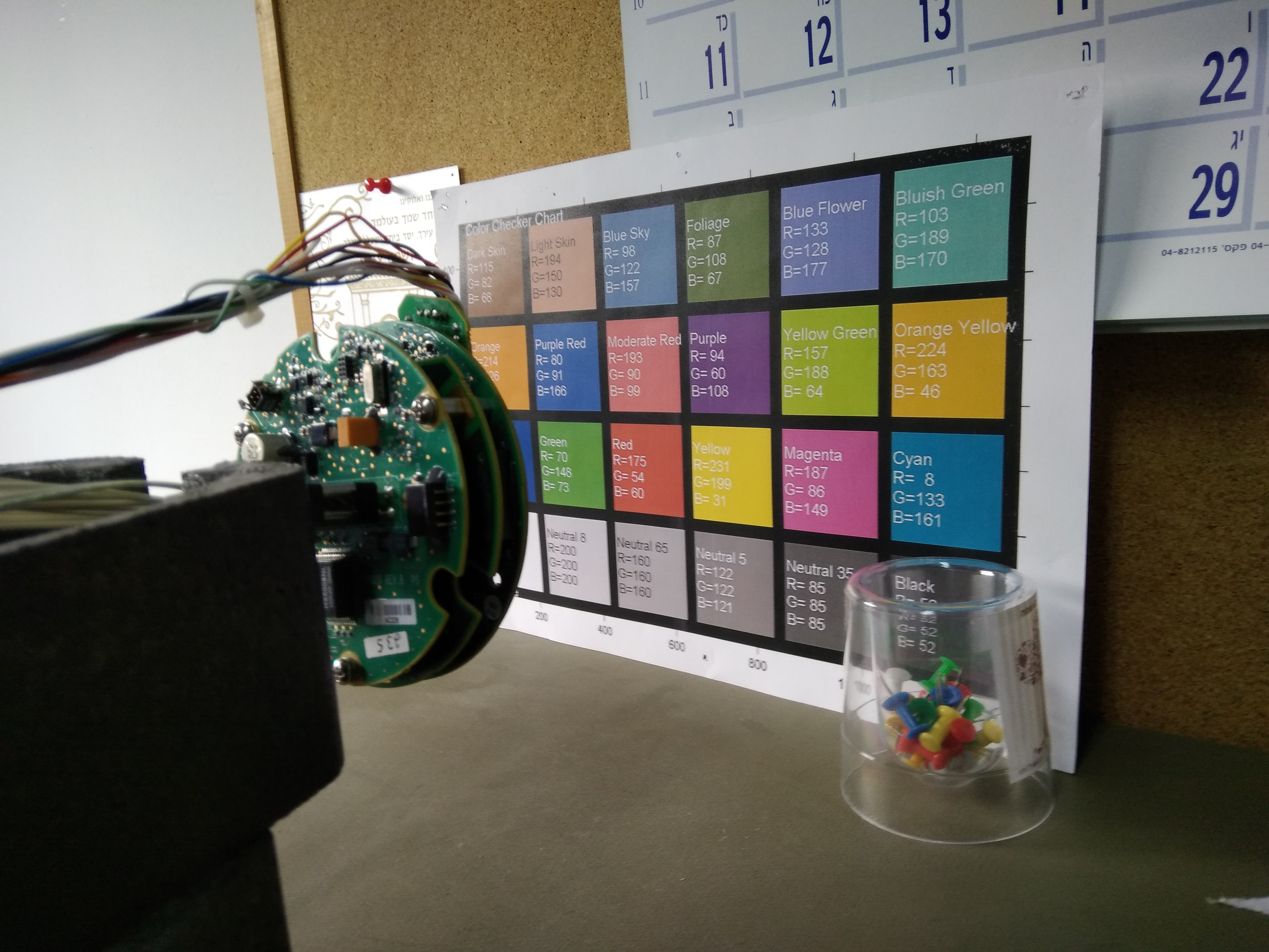

  • Thanks Gang.
    I'll attach a picture from my cellphone, a YUV and a RAW 12-bit. Resolution is 1600x1440.
    I compressed the files. Attached please find the ISIF register definitions (in jpg from screen shot) AR0331_1600x1440_Date_22-03-2018_Time_17-23-38.zipdcc_default.bin.zip and the AR0331 default_dcc.bin (with suffix zip - though not compressed) file used at the moment.
  • The pedestal in the raw file is 0 (not 168) and therefore the black level in ISIF shall be set to 0.
    However, the color in the attached YUV file looks worse than I would expect even with the wrong -168 black level.
    The attached raw file is badly overexposed, but attached yuv image is much darker.
    Something is wrong.
    Your screen shot of the raw above with a bigger view has good exposure.
    Can you send me that raw file as well?

  • Mechi,
    This raw image has a much higher black level, but it is probably due to the strong lens flare instead of the sensor pedestal.
    From these images, I think AWB and color correction have to be tuned for you camera module.
    To do that, it is better to tune everything in the linear sensor mode first to get the best image quality and then check the image quality in WDR sensor mode and make some adjustment as necessary.
    The second issue is that the gamma curve in IPIPE seems to be turned off (or linear) when I look at the captured YUV images.
    It reduces the dynamic range significantly.
    When tuning color in linear sensor mode, the gamma curve has to be set properly (e.g., the default one in RDK or BT709 gamma).
    After tuning everything properly in linear sensor mode and getting good image quality, you may change sensor to WDR mode with ALTM on and see what adjustment shall be needed.
    Tuning could be quite difficult if you don't have any experience and the necessary equipment. In that case, it is better to have a 3rd party do it for you.
    Gang

    In your situation with ALTM on, ISP pipeline H/W and AE/AWB are both required to convert 12-bit tone mapped Bayer pattern to 8-bit YUV.
    Bayer pattern is in 1 color per pixel raw format and ISP H/W is required to do noise filtering, bad pixel removal, color interpolation (demosaicing), color correction, gamma correction, and RGB to YUV conversion, edge sharpening, etc.
    You cannot simply take 8 bits from 12-bit Bayer pattern to get an output image with good image quality.
    I suppose Irfanview simply takes 8MSBs and do very simple demosaicing which give very low image quality (I cannot install Irfanview because it is not allowed at TI).
    Of course, for DM8127 ISP, tuning is required to achieve good image quality (with bad tuning parameters, image quality can get worse).
    I have some old 2012 DM365 IPNC AR0331 raw/yuv lab test images (linear sensor mode) to attached here later.
    You may open the raw images in Irfanview and compare to the yuv images from DM36x IPNC H/W ISP.
    I hope you may see the difference in color (both WB tint and color correction) and image details.
    Without proper AWB calibration, the overall color tone will be wrong.
    In your screen capture of the YUV image, there is strong purple color cast which is caused by improper calibration of AWB (AWB in RDK is calibration for TI IPNC reference design camera and lens module, and therefore it does not work with your camera module).
    In your Irfanview screen capture, there is a strong green color cast which is due to the lack of WB. (Iranview does a simple raw conversion with demosaicing and probably dropping 4LSBs, but does not do WB).
    BTW, the ALTM Bayer pattern you attached previously has limited quality in term of WDR tone mapping, exposure, and contrast.
    For the one with the window, the scene outside the window is completely saturated while the inside is heavily overexposed with poor overall contrast.
    For the earlier one with only the chart, the expose and contrast issue is similar.
    The cause of overexposure and poor contrast may be from auto exposure and/or ALTM.
    I am not familiar with this sensor ALTM, but I am sure tuning sensor ALTM and sensor exposure control for WDR use case is not trivial.
    I hope my explanations above are helpful for you to understand the situation.
    The recommended process of image quality tuning is to start with linear sensor mode to achieve image quality similar to the DM365 IPNC lab test images first.
    Then move to WDR mode to tune ALTM and WDR exposure control as part of AE control, and make other necessary (and expected to be small) ISP tuning changes.
    For your particular project, it is better to go with a 3rd party who has the experience and equipment.

  • >> You cannot simply take 8 bits from 12-bit Bayer pattern to get an output image with good image quality.
    We don't...
    I know - and am fully aware of this. I will be working on this with an expert who knows this sensor and will be able to output high quality WDR pictures.

  • I tried using the DCC file provided for the 10Mp sensor - but with the same purplish output...
  • >> The image data returned from the DCC has each row of Bayer pixels 12-bit packed – leaving unused bytes with 0x80 value at the last quarter of the row.
    This captured image is packed lossless from sensor output.
    >> The images – after expanding each row to full 16-bit pixel values and applying a trivial Gamma-1 decompanding are great images – as is – without further color processing.
    I have looked at all raw images you attached or showed as screen snapshots earlier and they all have poor quality.
    To get good ones in DCC tuning tool, you need to control sensor exposure properly from DM8127.
    Since RDK does support this ALTM sensor mode as Anand mentioned, AE cannot work properly with ALTM mode and therefore you won't be able to get well exposed raw images in general unless you are lucky at some scenes.
    To get your camera working fine with ALTM at the end, you probably need to rewrite AE.

    >> The default current IPNC processing chain takes these great images and generates purplish images.
    That is because the current IPNC tuning is done for the TI IPNC reference design cameras which is different from your camera lens module. You have to do tuning on your camera to get good quality.

  • Thanks Gang.
    That was a very detailed and information-filled answer.
    We have successfully received very good 12-bit RAW HDR frames.
    Something in the DCC/IPNC chain is removing parts of the details and changing the contrast and brightness of the frames.

  • Hi Mechi,
    It sounds like you made good progress.
    >> 1) In IssAlg_capt2AProcessTI (/ti_tools/iss_03_80_00_00/packages/ti/psp/iss/drivers/alg/2A/src/issdrv_alg2AApi.c) a gamma LUT table can be used (gamma_iss_default_table) to convert 10-bit to 8-bit (1024 --> 256 values). My data is coming from the AR0331 sensor as 12-bit. Should I supply a gamma table from 12 bit --> 8 bit or from 10 bit --> 8 bit.
    I am not sure about s/w implementation. The H/W ISP block IPIPE-Gamma has a 512-entry LUT of 10-bit each. The s/w may use a different LUT on different platforms. Sometimes, it could be a 1024-entry LUT with 8-bit each in s/w and conversion to H/W format is done by s/w. You may check the current LUT format (512 or 1024 entries) and follow the same.
    If you have ALTM in sensor, then you could start with the gamma curve of BT709 with proper format or follow ALTM's recommendation for gamma.
    >> In which module of the pipeline is the frame compressed from 12-bits to 10 bits?
    IPIPE-Gamma
    >> 2) We see that the AR0331 sensor software is able, with a CCM and AWB, to create a fine, detailed and uniformly bright picture. In the attached JPG, the RAW 12-bit image has much detail with uniform brightness. After the IPNC pipeline and conversion to H264, the final picture is missing much detail. How can all the detail be preserved and the CCM applied?
    The streaming video is very dark while "HDR_frame_12bit_1600x1440.raw" is very bright (I suppose this is the raw from sensor with ALTM). There must be some small gain and linear gamma curve to make it so dark, e.g., you use the top 8-bit of the 12-bit from raw may have similar effects.
    The image quality of "HDR_frame_12bit_1600x1440.raw" still have some issues. If you look at the front of the cup, there are many pixels clipped to very small values (2) from around 100~200 in neighborhood.
