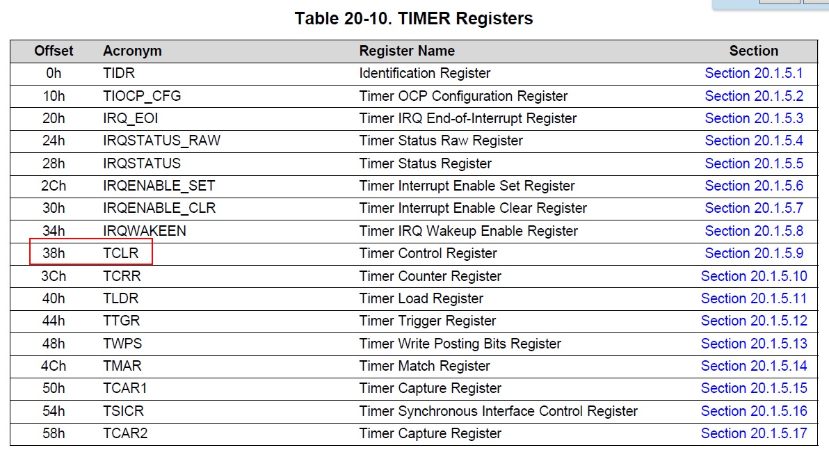

According to
ti-processor-sdk-linux-am335x-evm-02.00.02.11\board-support\linux-4.1.18+gitAUTOINC+bbe8cfc1da-gbbe8cfc\arch\arm\plat-omap\include\plat\dmtimer.h define,
struct timer_regs {

The TCLK offset should be 0x24, but according to TRM, it is 0x38h.
What is wrong?
  • Hi Tony,
    There is no mistake with TCLR register address define. Let's focus on the comments in ../arch/arm/plat-omap/include/plat/dmtimer.h :
    * The functional registers have a different base on v1 and v2 ip.
    * These registers are offsets from timer->func_base. The func_base
    * is samae as io_base for v1 and io_base + 0x14 for v2 ip.
    So 0x14 is added to io_base for v2 which is defined as:
    #define OMAP_TIMER_V2_FUNC_OFFSET 0x14
    and this macro participates in address calculation of timer->func_base:
    timer->func_base = timer->io_base + OMAP_TIMER_V2_FUNC_OFFSET
    Therefore the real offset of TCLR address register is 0x24 + 0x14 = 0x38 as it is described in table 20-10.
