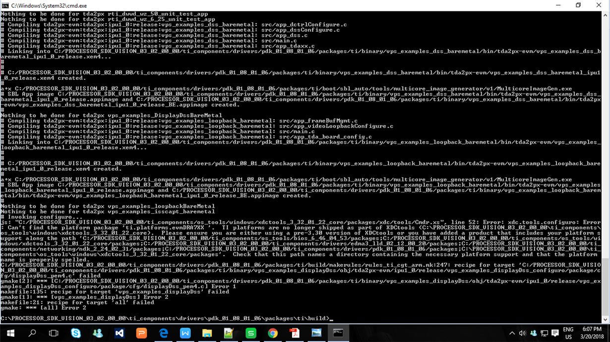

# Invoking configuro...
generating interfaces for package vps_examples_displayDssLowLatency_configuro (b
ecause package/package_vps_examples_displayDssLowLatency_configuro.c is older th
an package.xdc) ...
configuring displayDssLowLatency.xem4 from package/cfg/displayDssLowLatency_pem4
.cfg ...
# !!! Current build BOARD is [tda2px-evm] !!!
# !!! Current build SOC is [tda2px] !!!
# !!! Current build CORE is [ipu1_0] !!!
generating custom ti.sysbios library makefile ...
Starting build of library sources ...
Build of libraries failed.
error: xdc.cfg.SourceDir: "C:/PROCESSOR_SDK_VISION_03_02_00_00/ti_components/os_
tools/windows/xdctools_3_32_01_22_core/packages/xdc/cfg/SourceDir.xs", line 209:
xdc.cfg.SourceDir : Build of generated source libraries failed: exit status = 2
"C:/PROCESSOR_SDK_VISION_03_02_00_00/ti_components/os_tools/bios_6_46_04_53/pack
ages/ti/sysbios/family/arm/m3/Hwi_asm.sv7M", ERROR! at line 1937339231:
[E1500]
file access error: failed to open "m3_Hwi_asm.obj" for writing
INTERNAL ERROR: c:\PROCESSOR_SDK_VISION_03_02_00_00\ti_components\cg_tools\windo
ws\ti-cgt-arm_16.9.1.LTS\bin\armasm.exe experienced a segmentation fault
while processing file C:/PROCESSOR_SDK_VISION_03_02_00_00/ti_c
omponents/os_tools/bios_6_46_04_53/packages/ti/sysbios/family/arm/m3/Hwi_asm.sv7
M line 1937339231
This is caused by a defect in the compiler itself. TI Customer
Support may be able to suggest a workaround to avoid this.
Upgrading to the newest version of the compiler may fix this problem.
Contact TI in the E2E support forums at http://e2e.ti.com under
"Development Tools", "TI C/C++ Compiler". See the link titled
"Submitting an issue". Include this ENTIRE error message and a
copy of the .pp file created when option --preproc_with_comment
(-ppc) is used.
gmake[1]: *** [m3_Hwi_asm.obj] Error 1
gmake: *** [c:/PROCESSOR_SDK_VISION_03_02_00_00/ti_components/drivers/pdk_01_08_
01_06/packages/ti/binary/vps_examples_displayDssLowLatency/obj/tda2px-evm/ipu1_0
/release/vps_examples_displayDssLowLatency_configuro/package/cfg/displayDssLowLa
tency_pem4.src/sysbios/sysbios.aem4] Error 2
js: "C:/PROCESSOR_SDK_VISION_03_02_00_00/ti_components/os_tools/windows/xdctools
_3_32_01_22_core/packages/xdc/cfg/Main.xs", line 160: Error: Configuration faile
d!
xdctools_3_32_01_22_core\gmake.exe: *** [package/cfg/displayDssLowLatency_pem4.x
dl] Error 1

  • Hi Hrishikesh,
    Can you please specify the build command that you are trying? I will try the same here.
    Rishabh
  • Hi Risabh
    I tried to build by using the command gmake -s all BOARD=tda2px-evm CORE=ipu1_0
    when i changed core with ipu1_1,a15_0, c66x, arp_1, arp_2, I did not get any error.
    regards
    Hrishikesh
  • Hi Hrishikesh,
    The build is working for me.
    Can you share your Rules.make so that I can cross check if any differences are there.
    Rishabh
  • Hi Rishabh
    Please find attached rules.make (renamed as rules.txt) herein
    regards
    Hrishikesh

  • Hi Rishabh,
    We have used CCS7 gmake and compiled PDK using command "gmake -s all BOARD=tda2px-evm CORE=ipu1_0".
    We are still getting error which in this case is different from the previous one.
    Screenshot is attached for your reference.
    Abhay
