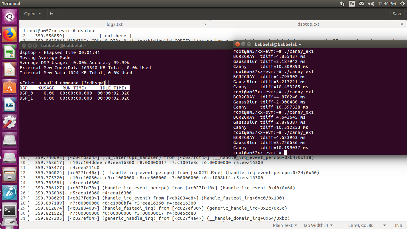

  • Hi Team,
    Linux Core(A15) is working fine on am5728 board.
    We are facing too many issue in using dsp core of am5728 board (with latest TI image version 04.02.00.09).
    Kindly provide the solution for each below mentioned points.
    (1) "dsptop" command is not working properly. kernel is getting dumped randomly.
    (2) Scenario 1: Application (with Opencl enabled) is able to run on DSP sometimes.
        Scenario 2: Application (with Opencl enabled) is not able to run successfully and it causes board in hang state and not able to access board.In this case,
                Issue 1: Minicom is not accessible.
                Issue 2: Board IP is not able to ping.
                Issue 3: Board is also not able to reboot successfully, even after pressing the board's power button.
    (3) In every successfully board reboot, Many error message are found in Reboot.log & on serial (i.e. Minicom) console.
    PFA of log file with respect to above mentioned points and provide the solution asap.
    Hope for your anticipating support asap.
    regards,
    Manish
    root@am57xx-evm:~# dsptop
    [  359.556859] ------------[ cut here ]------------
    [  359.563586] WARNING: CPU: 0 PID: 0 at /oe/bld/build-CORTEX_1/arago-tmp-external-linaro-toolchain/work-shared/am57xx-evm/kernel-source/drivers/bus/omap_l3_noc.c:147 l3_interrupt_handler+0x25c/0x36c
    [  359.581132] 44000000.ocp:L3 Custom Error: MASTER MPU TARGET L3_INSTR (Idle): Data Access in User mode during Functional access
    [  359.592569] Modules linked in: bc_example(O) sha512_generic sha512_arm sha256_generic sha1_generic sha1_arm_neon sha1_arm md5 cbc pru_rproc pruss_intc xhci_plat_hcd xhci_hcd usbcore xfrm_user xfrm4_tunnel ipcomp xfrm_ipcomp rpmsg_proto dwc3 rpmsg_rpc udc_core usb_common pruss esp4 ah4 af_key xfrm_algo bluetooth pixcir_i2c_ts snd_soc_simple_card snd_soc_simple_card_utils snd_soc_omap_hdmi_audio ti_vip pvrsrvkm(O) ahci_platform libahci_platform libahci debugss_kmodule(O) libata omap_aes_driver scsi_mod omap_sham mt9t11x omap_wdt extcon_palmas pruss_soc_bus omap_des ti_vpe ti_sc ti_csc ti_vpdma des_generic dwc3_omap crypto_engine extcon_core rtc_ds1307 rtc_omap rtc_palmas snd_soc_tlv320aic3x omap_remoteproc virtio_rpmsg_bus rpmsg_core remoteproc sch_fq_codel uio_module_drv(O) uio gdbserverproxy(O) cryptodev(O) cmemk(O)
    [  359.665726] CPU: 0 PID: 0 Comm: swapper/0 Tainted: G           O    4.9.59-ga75d8e9305 #2
    [  359.673937] Hardware name: Generic DRA74X (Flattened Device Tree)
    [  359.680054] Backtrace:
    [  359.682529] [<c020b29c>] (dump_backtrace) from [<c020b558>] (show_stack+0x18/0x1c)
    [  359.690134]  r7:00000009 r6:60000193 r5:00000000 r4:c1022668
    [  359.695821] [<c020b540>] (show_stack) from [<c04cd680>] (dump_stack+0x8c/0xa0)
    [  359.703077] [<c04cd5f4>] (dump_stack) from [<c022e3d4>] (__warn+0xec/0x104)
    [  359.710069]  r7:00000009 r6:c0bc8588 r5:00000000 r4:c1001d18
    [  359.715755] [<c022e2e8>] (__warn) from [<c022e42c>] (warn_slowpath_fmt+0x40/0x48)
    [  359.723271]  r9:00000000 r8:eea13e50 r7:c0bc83f4 r6:00000000 r5:c0bc84b4 r4:c0bc8558
    [  359.731051] [<c022e3f0>] (warn_slowpath_fmt) from [<c04fd530>] (l3_interrupt_handler+0x25c/0x36c)
    [  359.739959]  r3:eea13cc0 r2:c0bc8558
    [  359.743547]  r4:80080003
    [  359.746095] [<c04fd2d4>] (l3_interrupt_handler) from [<c027fcf4>] (__handle_irq_event_percpu+0xb4/0x138)
    [  359.755617]  r10:c104ddee r9:eea16300 r8:00000017 r7:c1001e3c r6:00000000 r5:eea16300
    [  359.763477]  r4:eea211c0
    [  359.766024] [<c027fc40>] (__handle_irq_event_percpu) from [<c027fd9c>] (handle_irq_event_percpu+0x24/0x60)
    [  359.775720]  r10:c10030ac r9:c1000000 r8:ee808000 r7:00000000 r6:c1008bf4 r5:eea16300
    [  359.783581]  r4:eea16300
    [  359.786127] [<c027fd78>] (handle_irq_event_percpu) from [<c027fe18>] (handle_irq_event+0x40/0x64)
    [  359.795036]  r5:eea16360 r4:eea16300
    [  359.798629] [<c027fdd8>] (handle_irq_event) from [<c02834c8>] (handle_fasteoi_irq+0xc0/0x190)
    [  359.807189]  r7:00000000 r6:c1008bf4 r5:eea16360 r4:eea16300
    [  359.812874] [<c0283408>] (handle_fasteoi_irq) from [<c027ef30>] (generic_handle_irq+0x2c/0x3c)
    [  359.821522]  r7:00000000 r6:00000000 r5:00000017 r4:c0e5cde0
    [  359.827205] [<c027ef04>] (generic_handle_irq) from [<c027f4a4>] (__handle_domain_irq+0x64/0xbc)
    [  359.835943] [<c027f440>] (__handle_domain_irq) from [<c02014a0>] (gic_handle_irq+0x40/0x7c)
    [  359.844330]  r9:c1000000 r8:fa213000 r7:fa212000 r6:c1001ef8 r5:fa21200c r4:c1003424
    [  359.852106] [<c0201460>] (gic_handle_irq) from [<c020c0f8>] (__irq_svc+0x58/0x8c)
    [  359.859619] Exception stack(0xc1001ef8 to 0xc1001f40)
    [  359.864689] 1ee0:                                                       00000000 00024d45
    [  359.872902] 1f00: eed3543c eed35430 00000000 00000000 00000001 c10030a4 00000000 00000000
    [  359.881115] 1f20: c10030ac c1001f5c 60000113 c1001f48 00000000 c028d030 60000113 ffffffff
    [  359.889327]  r9:c1000000 r8:00000000 r7:c1001f2c r6:ffffffff r5:60000113 r4:c028d030
    [  359.897108] [<c028cfc0>] (rcu_idle_exit) from [<c026eaec>] (cpu_startup_entry+0x180/0x230)
    [  359.905406]  r5:c100303c r4:c1000000
    [  359.909000] [<c026e96c>] (cpu_startup_entry) from [<c08ced4c>] (rest_init+0x8c/0x90)
    [  359.916774]  r7:ffffffff
    [  359.919322] [<c08cecc0>] (rest_init) from [<c0e00d80>] (start_kernel+0x3e0/0x3ec)
    [  359.926834]  r5:00000000 r4:c105104c
    [  359.930425] [<c0e009a0>] (start_kernel) from [<80008090>] (0x80008090)
    [  359.936977] ---[ end trace 4117405d2dba4a45 ]---
    dsptop - Elapsed Time 00:00:00
    Moving Average Mode
    Average DSP Usage:  0.00% Accuracy 100.00%
    DSP    %USAGE   RUN TIME+     IDLE TIME+
    DSP_0    0.00  00:00:00.000  00:00:00.000
    DSP_1    0.00  00:00:00.000  00:00:00.000>root@am57xx-evm:~#
    root@am57xx-evm:~#
    root@am57xx-evm:~#
    root@am57xx-evm:~#
    root@am57xx-evm:~#
    root@am57xx-evm:~#
    root@am57xx-evm:~#
    root@am57xx-evm:~#
    root@am57xx-evm:~#
    root@am57xx-evm:~#
    root@am57xx-evm:~#
    root@am57xx-evm:~#
    root@am57xx-evm:~#
    Moving Average Mode
    DSP_1    0.00  00:00:00.000  00:00:00.000>root@am57xx-evm:~# [  367.118464] omap_hwmod: mmu1_dsp1: _wait_target_disable failed

  • Hello Yordan.
    desktop issue is not resolved till now.
    when running application on dsp core and after use dsptop command then i got  dsp0 & dsp1 core is not loaded. Please find attached file.
    regards,
    Manish

  • Hi, Manish,
    Those kernel error messages from running dsptop is not fatal. dsptop is still usable. To remove those error messages requires a complete rewrite of debugss kernel module. We have internal record to track it.
    I'll close this thread. For issue running your opencv application, please open a new thread.

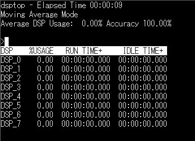

  • Part Number: AM5748
    Hello, TI Experts,
    We have an additional question about "dsptop" with PROCESSOR-SDK-LINUX-AM57X from below E2E-thread.
    https://e2e.ti.com/support/arm/sitara_arm/f/791/t/672985
    We can succeed to run "dsptop" on TMDSEVM572X with PROCESSOR-SDK-LINUX-AM57X 05_00_00_15 by modifying&building dts files including am57xx-beagle-x15-common.dtsi.
    Now we try to run "dsptop" on TMDSIDK574 by modifying&building dts files including am57xx-idk-common.dtsi.
    But we cannot success to run "dsptop" on TMDSIDK574.
    - At fiist, we can see the "dsptop display" like below.
       But after a few second past, the display disappeared.
    Question:
    Are there any missing including modification of am57xx-idk-common.dtsi?
    We would appreciate if you tell us the recommended way to run "dsptop" on TMDSIDK574.
    And we also appreciate if you check the attached below files (console log & dtsi file).
    - I add the below txt at line-192 in the attached dtsi file for modification.
    >       debugss: debugss {
    >       compatible = "ti,dra7xx-debugss";
    >       clocks = <&sys_clkin1>;
    >       clock-names = "sysclockin1";

    dsptop - Elapsed Time 00:00:03
    Moving Average Mode
    DSP_2    0.00  00:00:00.000  00:00:00.000
    DSP_3    0.00  00:00:00.000  00:00:00.000
    DSP_4    0.00  00:00:00.000  00:00:00.000
    DSP_5    0.00  00:00:00.000  00:00:00.000
    DSP_6    0.00  00:00:00.000  00:00:00.000
    DSP_7    0.00  00:00:00.000  00:00:00.000>dsptop - Elapsed Time 00:00:06
    Moving Average Mode
    DSP_7    0.00  00:00:00.000  00:00:00.000>dsptop - Elapsed Time 00:00:03
    Moving Average Mode
    Moving Average Mode
    DSP_7    0.00  00:00:00.000  00:00:00.000>dsptop - Elapsed Time 00:00:09
    Moving Average Mode
    DSP_7    0.00  00:00:00.000  00:00:00.000>dsptop - Elapsed Time 00:00:12
    Moving Average Mode
    DSP_7    0.00  00:00:00.000  00:00:00.000>dsptop - Elapsed Time 00:00:15
    Moving Average Mode
    DSP_7    0.00  00:00:00.000  00:00:00.000>dsptop - Elapsed Time 00:00:18
    Moving Average Mode
    DSP_7    0.00  00:00:00.000  00:00:00.000>dsptop internal error: Fatal: : Device not supported
    root@am57xx-evm:~#
