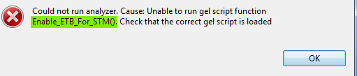

My understanding is, that if I select the following menu:
I would get a possibility to set up the system trace connection to the TDA3
I use these settings to get the trace data from the TDA3:
It then tells me, I need a gel script
I found these in the installation folder of code composer:
c:\ti7\ccsv7\ccs_base\emulation\gel\TDA3x\
So I load them into CCS.

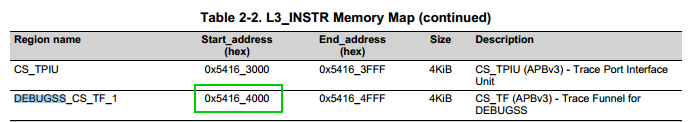

It turns out that the script  Enable_ETB_For_STM() does not work. (This by the way also a point of confusion, because the script actually seems to try to activate ETB, even though I want to use STM to trace out the data, and not the ETB as a circular storage)
It throws this error message:
Enable_ETB_For_STM() cannot be evaluated.
invalid page: data
	 at (int *) 0xD4164FB0@data [TDA3xx_stm.gel:64]
	 at Enable_ETB_For_STM()
The @data keyword seems to be the trouble. Nevertheless, I am not even sure if that address would be even correct. If I open that in the memory browser, it tells me there is nothing.
Shouldn't it be rather the address: 0x54164000
As from the datasheet I see:
So my question would be. Am I on the right track to get STM working.
If yes, can TI provide me with the correct set of gel files. I have checked the latest CCS v8.0.0.00016 , but it has basically the same gel files.
What be even more smashing, if someone could verify on their side with a similar setup, if what I am trying to do does work.

  • Hi Mate,
    We need to do a bit of digging to find out more details on this as ideally the script should have worked. We will get back to you by Thursday.
    Rishabh
  • Hi Mate,
    Even though you are trying to run pin trace and not ETB trace, the Enable_ETB_For_STM() function is still intentionally called to configure the trace funnel for STM. The Enable_ETB_For_STM() gel function is intended to be run from the DAP.  In your case, I'm guessing the gel files were not loaded on the DAP which is why the 0xD4164000 address didn't work.  To work around this, you can attach ccs_base\emulation\gel\TDA3x\TDA3xx_dap_startup.gel to the dap00 core in your ccxml which will in turn automatically load the Enable_ETB_For_STM() function.
    I have attached a ccxml (rename from .xml->.ccxml) that I tested with based on your original ccxml.  Let me know if you have any further questions.

    Mark
  • Hi Mark,
    Thanks a lot for the right pointer.
    It seems like it is working now.
    I have to experiment with the STM to see what it can actually do.

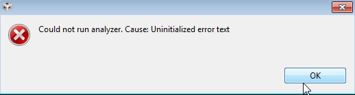

  • Hi again!
    I just played around quickly.
    Actually I started to use the ETB receiver, which works now with STM. (see my previous message)
    But if I set the transport type to 560 V2 Trace option, I get this error message:
    Currently I have the Spectrum Digital XDS560v2 STM Traveler connected.
    I'll dig around on my side for further details later.
    I I have something more in detail, I'll be back.
    Thanks a lot.
  • Hi Mate,
    Sorry for the delay and for the unhelpful error message.  There was actually a fix to provide a more descriptive error message in our latest release.  You can pick this up with Help->Check For Updates and updating TI Emulators to version 7.0.188.0.  This might give us more of an idea of what may be going wrong.  Additionally, if you could provide a trace log, it would be helpful in diagnosing this issue.
    The steps for capturing a trace log are here (see TI_TRACE_LOGGING environment variable):
    I've tested this locally with the 560v2 LAN probe (I don't have a traveler to test) and was unable to reproduce here.
    Mark
