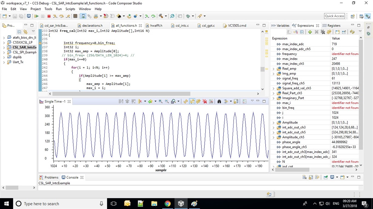

  • Ohk i got it Mark..still i am not getting the exact frequency of the signal..I dont understand whats wrong..following is my FFT calculation function.

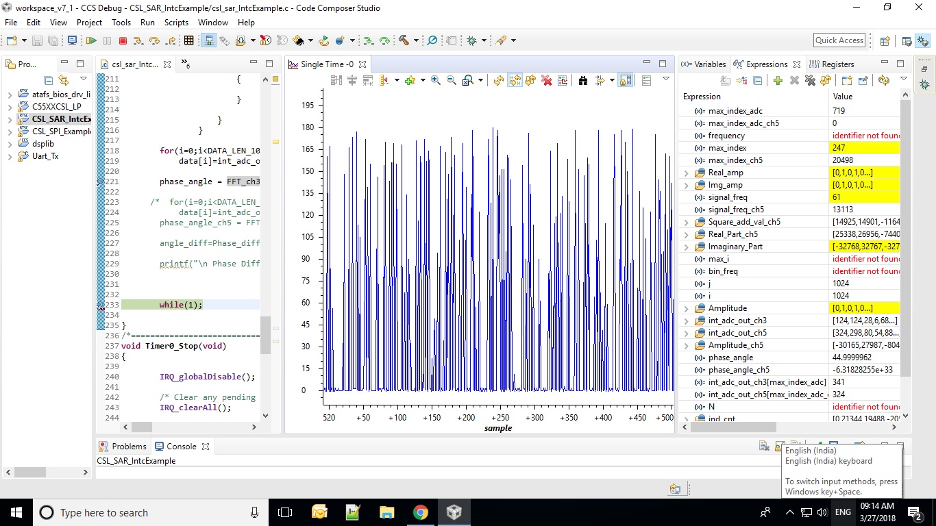

    OUTPUT is attached. Graphs of FFT magnitude, ADC signal.

  • Hi Kanchan,
    I'm concerned about the number format.
    The input and output vectors of the HWAFFT contain complex numbers. Each real and imaginary part is represented by a two’s complement, 16-bit fixed-point number. The most significant bit holds the number’s sign value, and the remaining 15 are fraction bits (S16Q15 format). The range of each number is [-1, 1 – (1/2)15]. Real and imaginary parts appear in an interleaved order within each vector.
    To extract the real and imaginary parts from the complex vector, it is necessary to mask and shift each 32-bit element into its 16-bit real and imaginary parts:
    Uint16 Real_Part = CMPLX_Vec32[i] >> 16;
    Uint16 Imaginary_Part = CMPLX_Vec32[i] & 0x0000FFFF;
    You have this part backwards...
    Real_Part[i] =data[i] & 0x0000FFFF;
    Imaginary_Part[i] = data[i] >> 16;
    You must also put the input vector in this format
    Int32 *data // all data buffers must be aligned in memory see appendix of SPRABB6 for methods
    for (i=0;i<FFTLENGTH;i++)
    data[i] = 0; // clear imag part and zero pad if data buff less than FFTLENGTH
    if(i < DATABUFLEN)
    data[i] |= inputbuf[0] << 16; // push 16-bit input vector data into real part of data buf before HWAFFT
    When you graph the input data, you should skip over the imag parts and graph only the real parts. To do this, use 16-bit signed integer data type, Index Increment 2 (to skip over imag parts), and set the Q value to 15 (since there are 15 quotient/fraction bits). Then the input should be centered about 0 and should be in the range -1 to 0.9999. This will verify the input signal is correct. The same settings can be used to graph to the output signals.
    Your graph shows the input signal range from decimal 0 to 325. That seems to have a DC offset and small amplitude. If you are getting these numbers from the SAR ADC, then the input signal to the SAR should be centered about VREF / 2. The SAR ADC outputs are in the range from decimal 0 to 1023 (10-bit SAR ADC). Without remapping the numbers to 2's complement Q15, I would expect FFT bin 0 to be large due to DC offset. A typcial audio codec like AIC3204 will provide you native 16-bit 2's complement signed fractional numbers centered about 0.
    Mark
