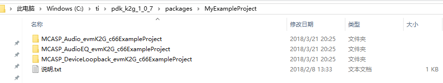

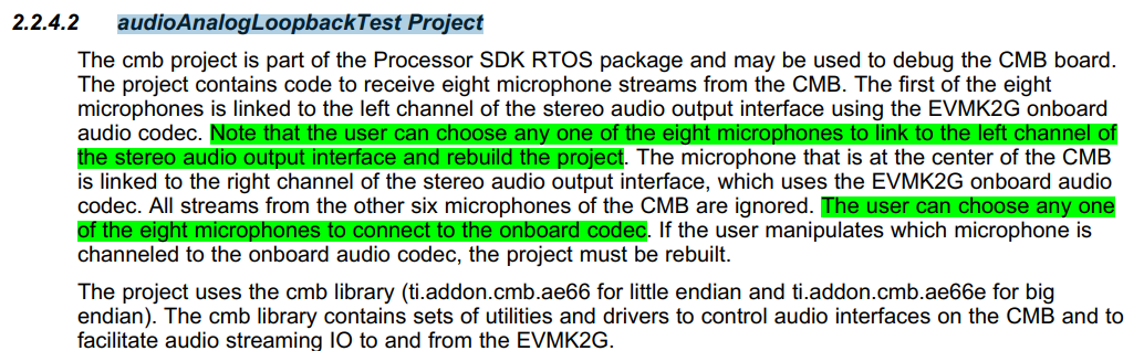

From TI Designs: TIDEP-0088 Audio Pre-Processing System Reference Design for Voice-Based Applications Using 66AK2G02. We know that in the pdk_k2g_1_0_7 ,there is a audioAnalogLoopbackTest Project source ,as is show in the picture :

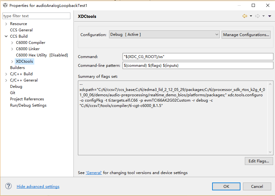

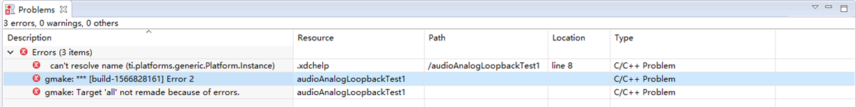

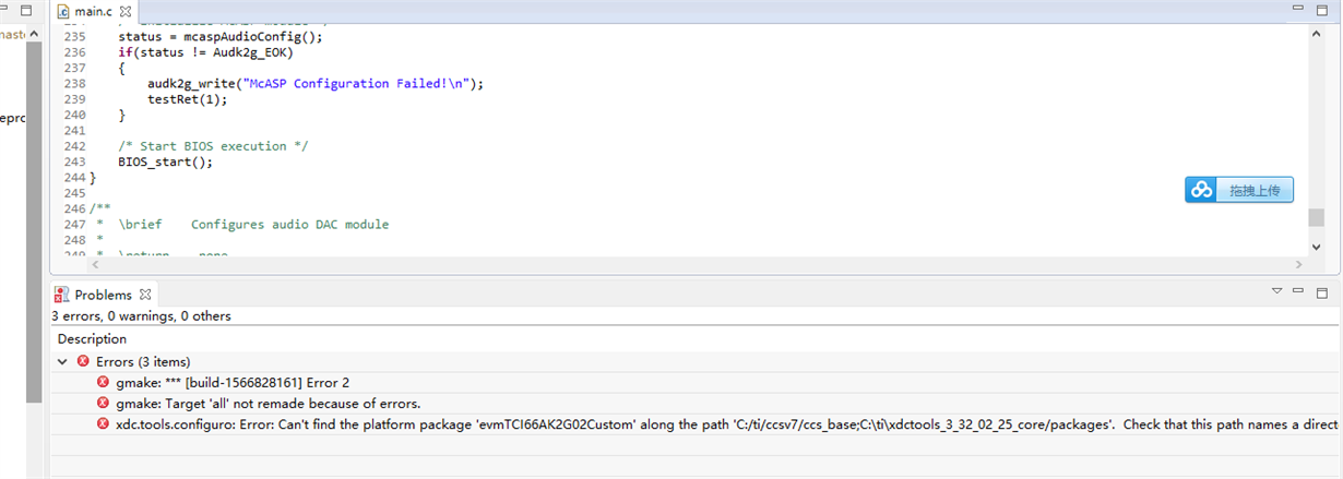

We want use them to test CMB board ,but there is no a single ccs project in the loopback file ,we can not open them as a complete project .we can use pdkProjectCreate.bat instructions to create project ,as is show in the picture.But when we put the loopback source files in the project ,there are mistakes in them ;
how can we use the loopback source files and pdkProjectCreate.bat to make a right ccs project or is there a project for the audioAnalogLoopbackTest ? How can we get them. Thank you for your help .
