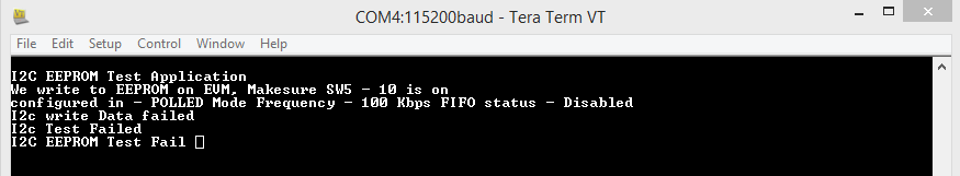

We have performed i2c eeprom test application on TDA2px EVM but it got failed.

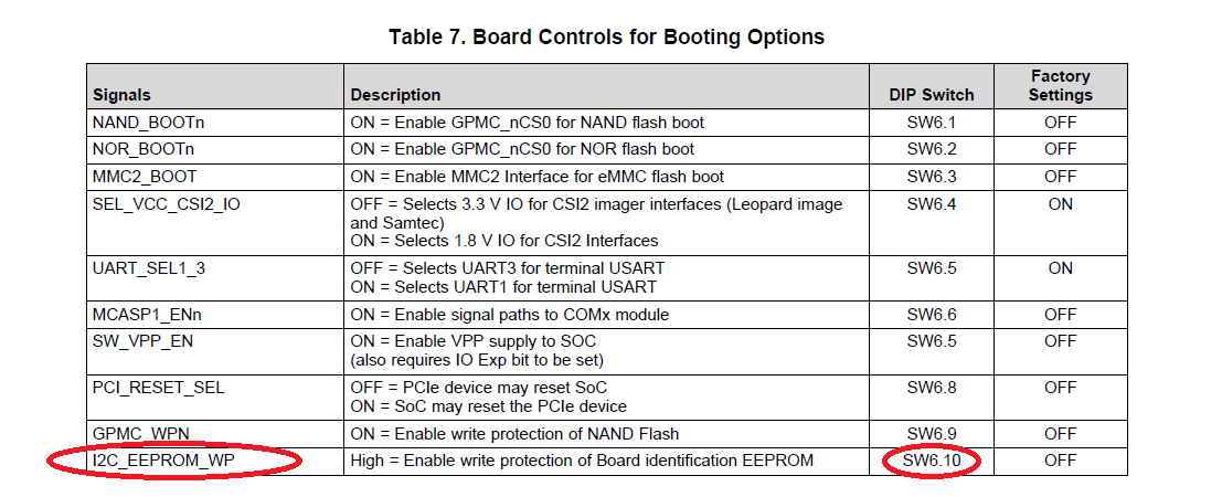

Below is the attacahed console screenshot which says SW5 - 10 should be 'on'

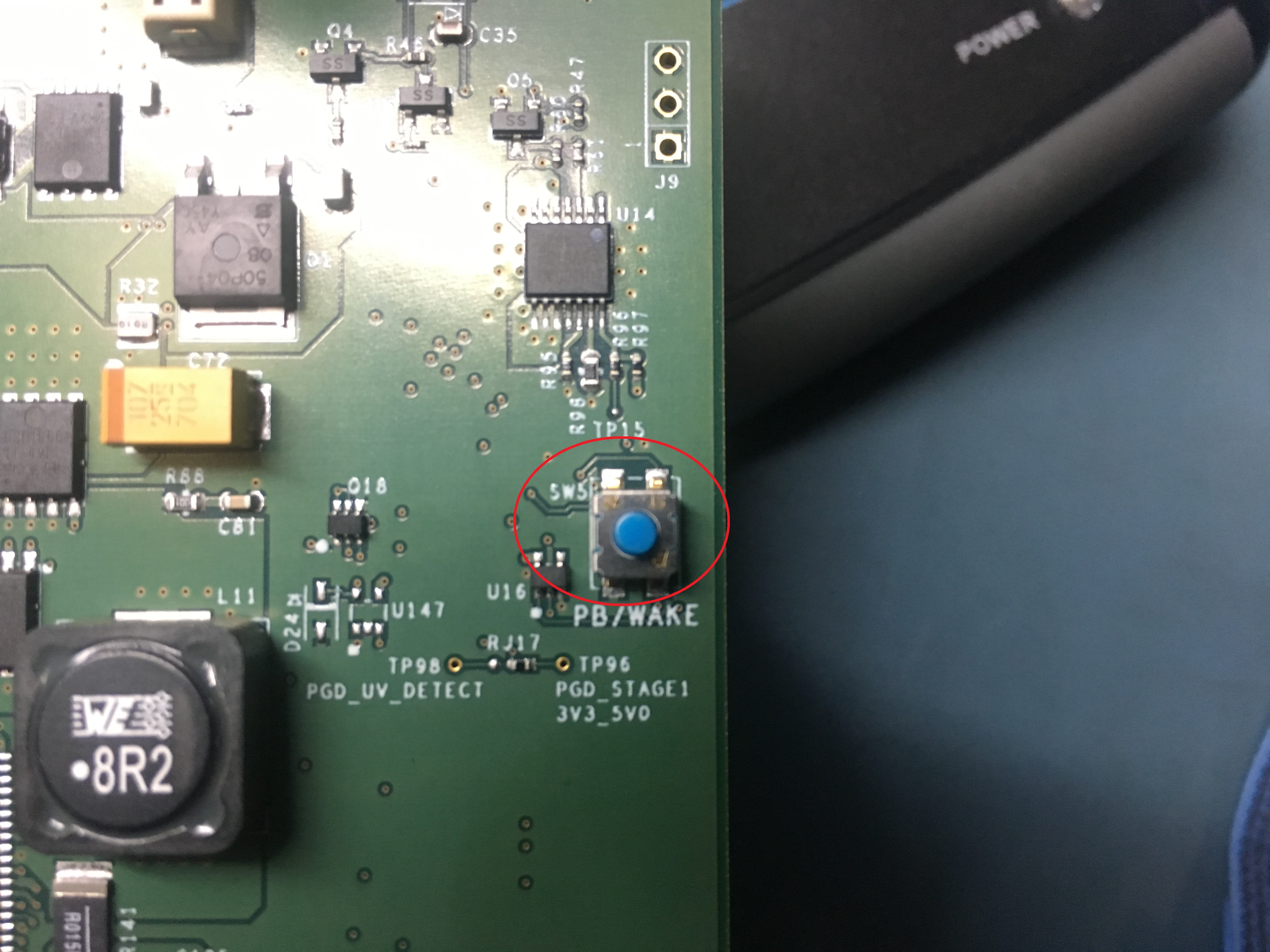

But we found out that SW5 is only a single button on the TDA2px EVM board.
So what setting is to be done for the "SW5" to test the eeprom application on this EVM.
Below is the attached image of the SW5  on the EVM.
