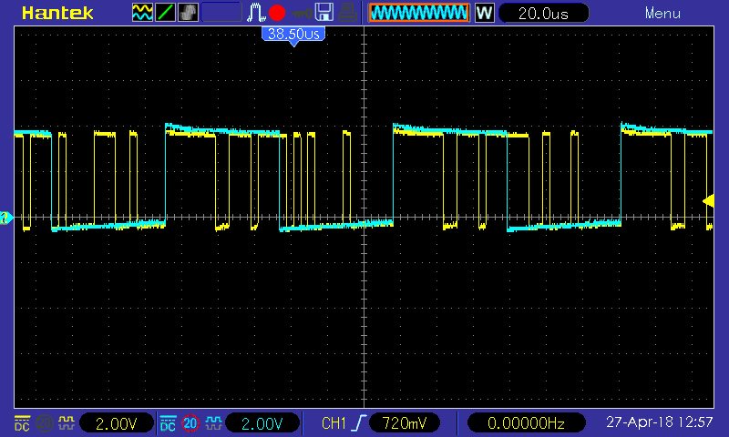

    We are using the asoundlib (#include <alsa/asoundlib.h>) and fairly standard techniques to read from our streaming codec device. Here is a cap showing our input (Frame Sync and Data signals):
    The above data shows what we expect - 24 bits of data (single channel) followed by 8 bits of status within each frame sync period (125 uSec or 8K samples/sec).
    Our app is doing the following.
