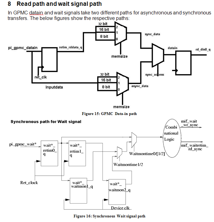

Customer is connecting an FPGA to AM5726 over GPMC using synchronous multiplexed 16-bit NOR flash mode. The timing diagram for this mode depicted on Fig 7-7 in Data Manual is not sufficinetly clear to
implement the FPGA side of the interface. The relation between gpmc_oen_ren and the data signals (gpmc_ad[15:0]) appear quite logical and consistent
while it is not clear at all how the timing of the gpmc_wait fits in with the other two.Couple of questions:
1. What is the polarity of the gpmc_wait signal on this diagram: active high or active low?
2. if it is active low - why gpmc_oen_ren activates before gpmc_wait deactivates? Shouldn't it be the other way around?
3. if it is active high - why wait activates during data transfer?

    First of all, the WAIT signal is not required to be used if the read latency is deterministic. The GPMC is cycle-based - counters (like OEONTIME and OEOFFTIME) are programmed to activate and deactivate each control signal. Similarly, data is latched when the RDACCESSTIME counter expires. If a memory is not deterministic, then it can drive the WAIT signal to delay the latching of data it puts onto the data bus. The effective access time is a logical AND combination of the RDACCESSTIME timing completion and the wait-deasserted state detection.
    TRM Figure 15-61. Wait Behavior During a Synchronous Read Burst Access (see below) shows more detail about the control signal ON/OFF times, read access time, and the involvement of the WAIT signal.
    MM: Active low is shown. WAIT can be configured as active low or active high.
    The polarity of the wait pin is defined through the WAITxPINPOLARITY bit of the GPMC_CONFIG register. A wait pin configured to be active low means that low level on the WAIT signal indicates that the data is not ready and that the data bus is invalid. When a wait pin is inactive, data is valid.

    MM: TRM Figure 15-61 is a better figure.
    See also the below flops used to latch the WAIT input. It may help to understand the different Waitmontime settings that are shown in Figure 15-61. note that the Ret_clock is the retiming GPMC_CLK after it is looped back from the IO pad. It helps the timing requirements.
