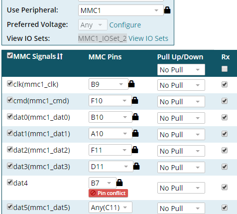

Hi, everyone:
The pinmux tool have a error when I try to assign B7 as the MMC1 's DAT4:
It seems there are some fixed pinmux solution:
But there are no such limition on the datasheet:
  • Section 4.3 of the AM437x Datasheet Rev. D states:
    "... Although there are many combinations of pin multiplexing that are possible, only a certain number of sets, called IO Sets, are valid due to timing limitations. These valid IO Sets were carefully chosen to provide many possible application scenarios for the user."
