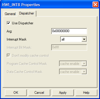

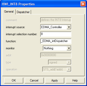

  • Have you plugged EDMA_intDispatcher into the vector table?  Also, you should should remove EDMA_intClear since that is already handled by EDMA_intDispatcher.

  • The callback function is ultimately interrupt based.  You need to plug EDMA_intDispatcher into the interrupt vector table, i.e. use a BIOS HWI.  When the transfer completes it triggers an interrupt which then runs EDMA_intDispatcher which then calls the function associated with the CIPR bit that is set, i.e. your callback function.
    A couple other notes:
    • SEM_ipost is deprecated (i.e. discouraged).  Use SEM_post.
    • Since your callback function is being called from within a HWI (i.e. from EDMA_intDispatcher) you must use the interrupt dispatcher in order to call SEM_post.  Otherwise you will "confuse" the BIOS scheduler since it won't "know" that an interrupt has occurred.
    Here are some screenshots for you:
    You will of course need to also enable this corresponding interrupt in the CPU's IER.
    Brad

    I needed to plug the EDMA_intHandler() call to a HWI service to get it to call my function correctly.  I added the HWI for the EDMA_Controller to the tcf file, added that code and all seems good now!
    Changed the deprecated SEM_ipost() and removed the EDMA_intClear() call too from the isr routine while I was at it.
