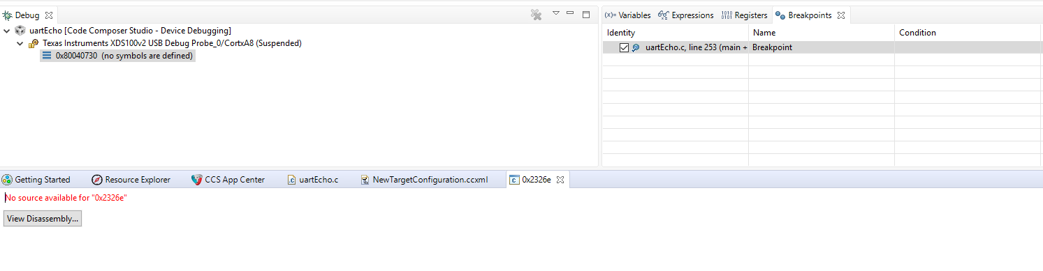

When I import uartEcho project from AM335X_StarterWare_02_00_01_01 into a CCS version: 7.4.0.00015, compilation was successful but when I start debugging it's suspended. Is there a manual/user guide to run this application? Thanks in advance.

    screenshot is posted bellow.

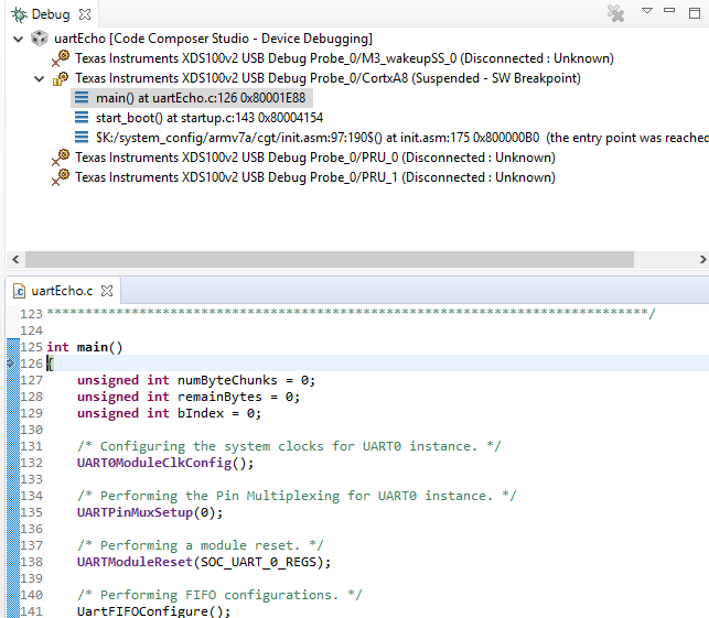

  • Thanks. Being suspended is not the issue. Actually, when you debug a project it is supposed to auto-connect, load the program, run to main, and stay there. This is what I see when debugging uartEcho on my beaglebone
    But in your case it is suspended at some address with no source code correlation. Which example did you use (for what target)? I used the beagleboard one since that is my target. I didn't see one for TMDSICE3359. If you tried using one of the examples for another target, maybe that is why it is not working. If you can confirm, I will move this thread to the Sitara forum for more assistance.
    ki
  • Hi Ki,
    Thank you! That was helpful but now even I stand at the same point as your screenshot. Further are you able to see the echo in terminal?
