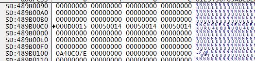

I'm currently using 2MP camera sensor for csi2CalMultiCam_View usecase (in VisionSDK3.2).
The YUV stream format from the sensor is like below - each components have 10 bits:
To support this stream, I changed inCsi2DataFormat to VPS_ISS_CAL_CSI2_YUV422_10B (0x1F) and extract type to VPS_ISS_CAL_PIX_EXRCT_B10_MIPI but I'm not getting correct image (all greeny image).
Do I need to change other things to get the correct image from the stream above?
When we change the camera sensor to use 8 bits (instead of 10 bits) we can see the image correctly.

  • Hi James,
    Please note that when you capture 10bit yuv output, it will be stored in the 16bit container. CAL cannot convert 10bit to 8bit output and stored it as YUV422 8b. So can you please first check if the captured image is correct by looking into pixel values in some hex viewer? it should have exactly 10bits per component.

  • Hi James,
    If the Pixel extract module is enabled, output from the CAL is not stored in this format. The extract module will extract pixel data from MIPI format and convert into linear format. So the output should be stored in
    Cb[15:0] with lower 10bits valid and upper 6 bits 0
    Y[15:0] with lower 10bits valid and upper 6 bits 0
    Cr[15:0] with lower 10bits valid and upper 6 bits 0
    If this is not how output you are getting, either extract module is not enabled or input is not in 10bit MIPI format. Can you share the CAL register to check? I am interested in register CAL_PIX_PROC_i (0x5201 20C0 + (0x4 * i)).
    This is where we enable pixel extract module.
    Brijesh
  • Hi Brijesh,
    Here's the register dump for CAL_PIX_PROC_i when we capture the video frame.
    I think the extract module is enabled and extract in 10 bit MIPI (0x4), pack in 16 bit (0x5).
    James
  • Hi James,
    From the register,
    Pixel Processing Context0 = 1
    CPortID = 1
    Packing = 16bit
    Extract Bits[4:1] = 16-bit (little endian) = bypass
    It looks like extract is not enabled for MIPI 10 bit. Can you please try changing this register.

  • Hi Brijesh,
    After changing extract to 10 bit MIPI (Extract Bits[4:1] = 0x4) we got frame dump as below:
    It seems it's an 8 bit container (not 16 bit)?
    Byte 0: 0x0F  -> U
    Byte 1: 0x02  -> Y
    Byte 2: 0xD1  -> V
    Byte 3: 0x01  -> Y
    And the image is not shown correctly still.
    Any ideas on it?
    James
  • Hi James,
    This seems like a 16 bit container. I believe the source is 10 bit and as you can see the data Byte even & Byte odd dosen't exceed 10 bits.
    To confirm if the video is received correctly, view the dumped image in PC YUV viewer.
    The issue is we cannot display 10 bit YUV. you will have to convert from 10 b to 8 bit.
