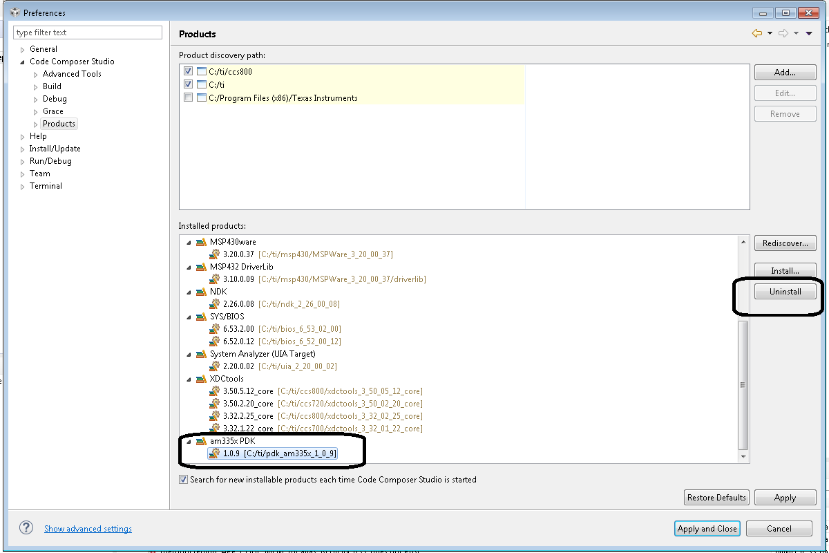

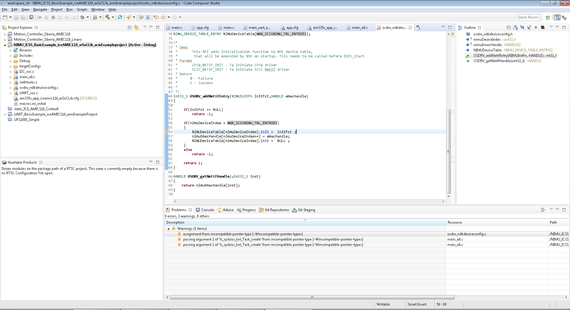

Hello.

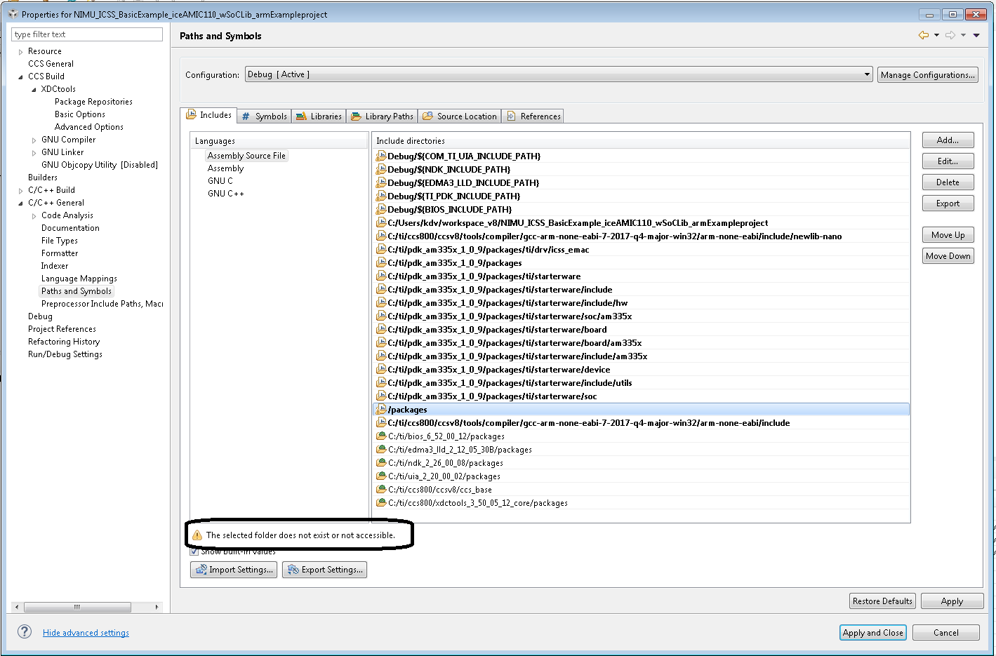

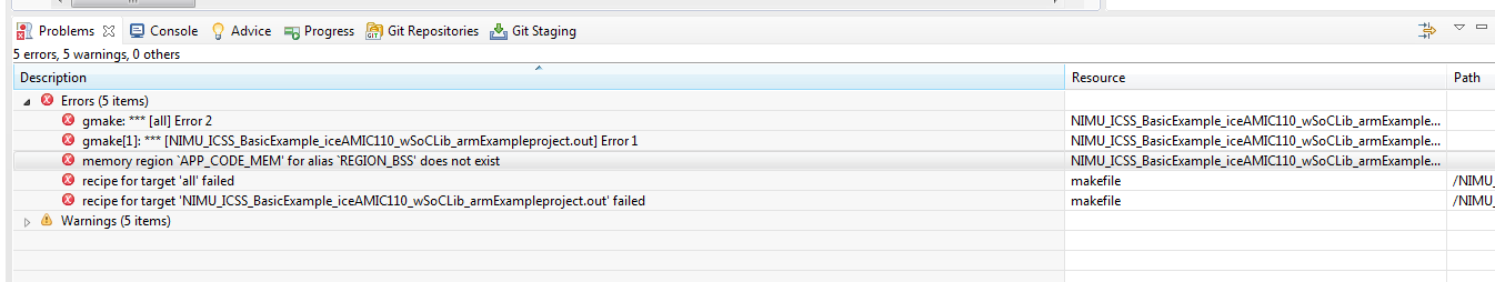

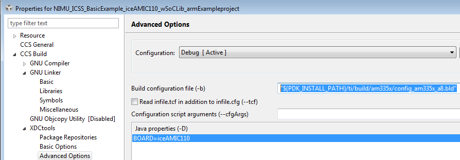

Today I again tried deal with example NIMU_ICSS_BasicExample_iceAMIC110_wSoCLib_armExampleproject. It was working. But after I tryed load my another project to FLASH and after I return to NIMU_ICSS_BasicExample, I get errors. When I working with FLASH project, I'm changed some options in CCS and not remember. After maybe, NIMU_ICSS_BasicExample was corrupted. Now I can not restore the correct operation. Removing and re-importing the project from the PDK folder gives the same result. What are the ways to resolve?
For example, NIMU_BasicExample_bbbAM335x_armExampleproject, compiles and works.
