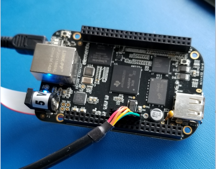

    2) I tried to connect a FTDI cable to header J1 and modified the code fro btuart_loop_test() to the below:

    Here is the output on UART1 on the teraterm console BAUD 115200
    Now, obviously this is 1 way traffic where the BBB is sending the messages to UART1 output to the console. Did this work for you?

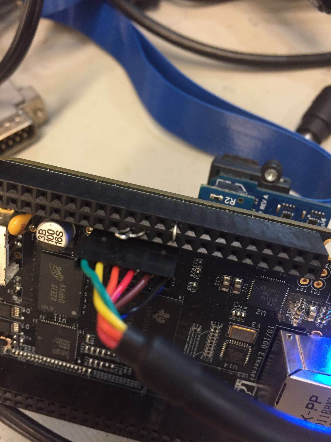

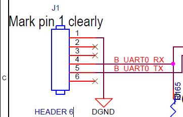

    1,   "Loop 0 test succ!"  from uart0 of BBB, You can connect a uart->usb cable to J1 of BBB. The uart0 init code at main()->board_init()->uartstdioint()->console_uart_init()->UARTStdioInitExpClk()
    I'm not used ROV.
    Here is my HW connection, it short connect uart1 rx-tx  rts-cts:
    2, Seem you delete recmflag and sendflag flag test code. Please don't modify the code. Just LOAD PRORAM->RESTART  [->RUN
    you can see the log from uart0
    If you don't restart   directly click run , you will see nothing from uart0. This is the issue what I want you help to debug.
