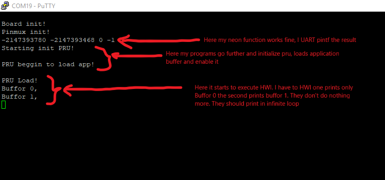

I've run into a problem. When I'm trying to add a basic neon assembler function from ne10 project my program crash in a weird spot. It completes the ne10 function fine and after it works for only for a couple cycles and then pauses. When I comment out the ne10 add function everything works fine. The function doesn't produce the crash just after running couple line of codes it magically stops. I'm not sure why. Maybe I have to initialize somehow the neon or do something like that. I have to HWI and all the do is printf buffer 0/1 nothing special. It's really weird if the program would crash right after my ne10 function everything would suggest the assembler function cause the problem now I'm not sure what is the problem. Can anybody help?

    When I dont execute neon function (3.) everything works fine and I get on the console infinite signes
    Buffor 0
    Buffor 1
    But when I want to use neon functio something crash
  • Ok, I found my bug. I'm new to assembly and I start my code by pushing form stack r5 r6 and r7:
    push {r5}
    push {r6}
    push {r7}
    mov r5, r2
    ...(here is the rest of the code but not important for the problem)
    and I end it up with:
    mov r0, #0
    bx lr
    I forgot to pop r5, r6, r7 so my end of code should look like
    pop {r5}
    pop {r6}
    pop {r7}
    mov r0, #0
    bx lr
    probably the r5 r6 or r7 register get stock and the rest of my code couldn't use it. If someone could leave a comment about what exactly happen I would appreciate it.
