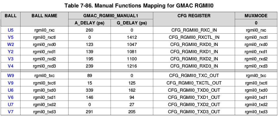

    in muxdata.h file, iodelay_cfg_array_x15_sr2_0[] CFG_RGMII0xxxx value
    and
    In datasheet, CFG_RGMII0xxx value
    Shinji Ueda
    Could you elaborate which SDK are you using?
    I am checking TI Processor SDK Linux 04.02.00.09 and the values (a_delay & g_delay) for RGMII0 are the same as datasheet:
    {0x06F0, 260, 0}, /* CFG_RGMII0_RXC_IN */
    {0x06FC, 0, 1412}, /* CFG_RGMII0_RXCTL_IN */
    {0x0708, 123, 1047}, /* CFG_RGMII0_RXD0_IN */
    {0x0714, 139, 1081}, /* CFG_RGMII0_RXD1_IN */
    {0x0720, 195, 1100}, /* CFG_RGMII0_RXD2_IN */
    {0x072C, 239, 1216}, /* CFG_RGMII0_RXD3_IN */
    {0x0740, 89, 0}, /* CFG_RGMII0_TXC_OUT */
    {0x074C, 15, 125}, /* CFG_RGMII0_TXCTL_OUT */
    {0x0758, 339, 162}, /* CFG_RGMII0_TXD0_OUT */
    {0x0764, 146, 94}, /* CFG_RGMII0_TXD1_OUT */
    {0x0770, 0, 27}, /* CFG_RGMII0_TXD2_OUT */
    {0x077C, 291, 205}, /* CFG_RGMII0_TXD3_OUT */
    Here is a screenshot from the datasheet:
    Or have I misunderstood the question and looking at something else?
    Yordan
