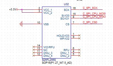

My application is built with AM3352. The main flash memory is spansion SPI Flash named FL256SA1F00.

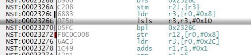

I traced the masked boot code in AM3352 and found forever loop related SPI flash memory.
Code from 0x2326C to 23270 means to check read SPI IRQStatus register.
r3 has address 0x48030118
Target board with trouble has zero in r3. So boot process does not continue any more.
Normal (operating well) board has 0x05 Value in that time (r3)

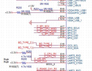

Below is circuit related with CPU/SPI Interface.

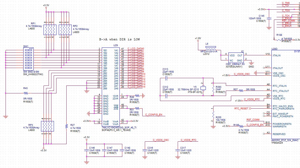

And sysboot configuration.

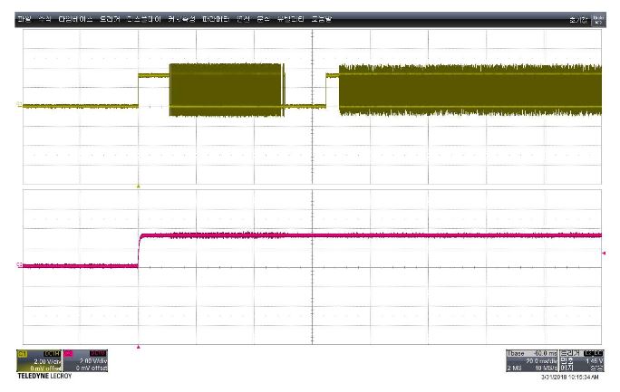

PS) I am uploading more signal information.
First case : when AM3352 has successful booting seq, the upper signal in scope is SPI SLK and below is MCU RESET.

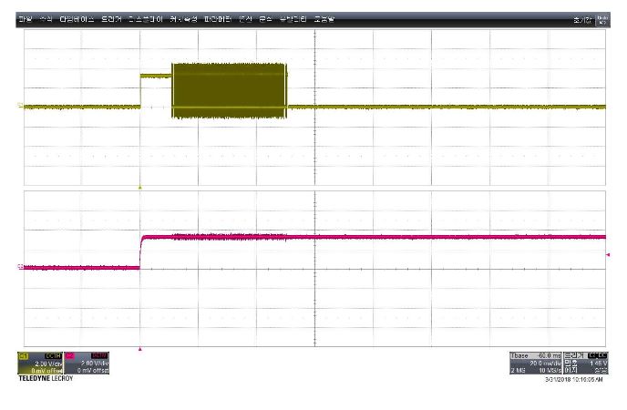

And during the fail condition, signal condition

    1. Have you ruled out an assembly error? Double check the data signals and CS with a scope, to insure data is being transmitted during that first burst of CLK. Compare with a working board to see where a difference occurs in the command sequence.
    2. Ideally, there should be a small series resistor on the CLK signal, located close to the processor. This is to mitigate reflections on the clock when reading data (the clock is used to re-time data returning from the SPI flash). It would be difficult to see this unless you have a probe point close to the processor. How much distance is between the processor and flash memory?
    3. If you are getting stuck at the same point in the ROM on all the boards, i think you sysboot signals are fine.
    4. Schematics look fine, especially since you can get a majority of boards working.
