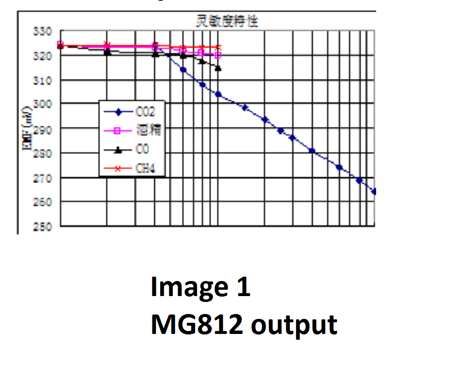

i have MG812 sensor which has output of mV drop as the volume increase as i have attached image 1
as required output is as following IN VOLTAGE
PPM
VOLTAGE OUTPUT
0
0
1000
0.5
5000
2.5
10000
5
