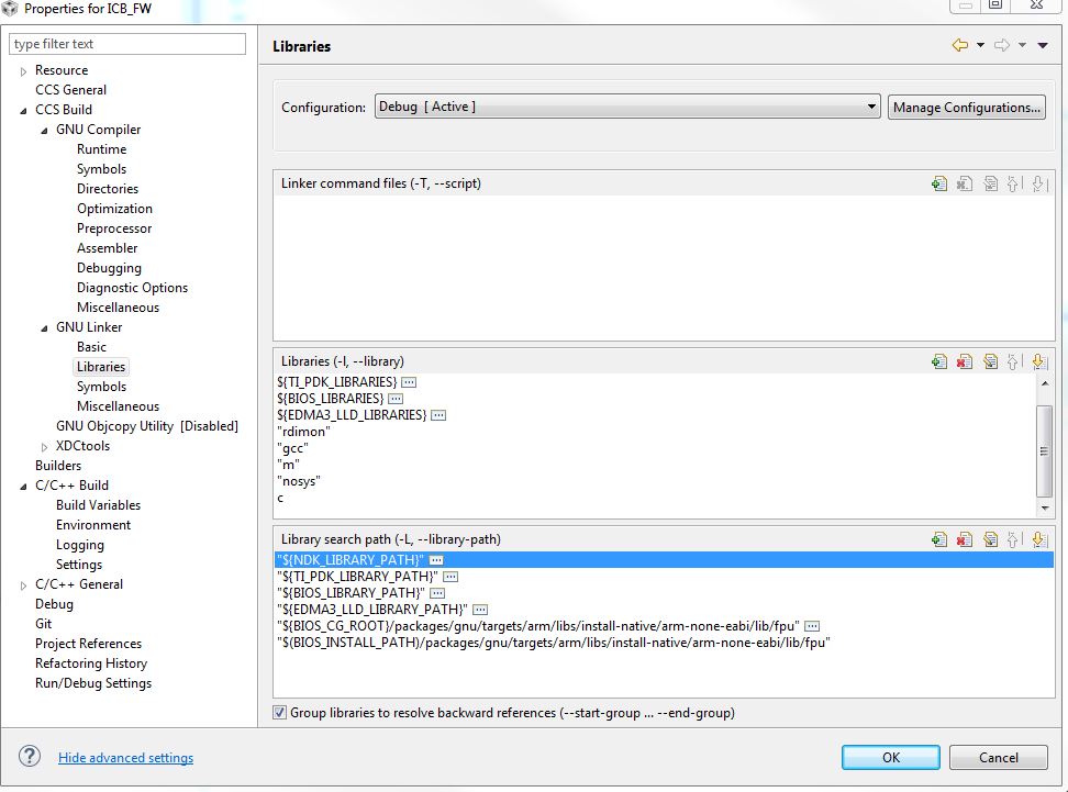

I am trying to update my PDK liberary form 1.0.5 to 1.0.9. I download the latest SDK. My code comples fine with PDK_1_0_5, but it occurs the following error with PDK_1_0_9. Does anyone have idea on this?
akefile:165: recipe for target 'ICB_FW_LP.out' failed
C:\ti\pdk_am57xx_1_0_9\packages\ti\drv\mmcsd\lib\am572x\a15\release\ti.drv.mmcsd.aa15fg(MMCSD_v1.oa15fg): In function `MMCSD_v1_open':
C:\ti\PDK_AM~1\packages\ti\drv\mmcsd/src/v1/MMCSD_v1.c:736: undefined reference to `MuxIntcP_create'
collect2.exe: error: ld returned 1 exit status
gmake[1]: *** [ICB_FW_LP.out] Error 1
gmake: *** [all] Error 2
makefile:161: recipe for target 'all' failed

    This indicated the MuxIntcP_create is missing, when linking, do you have OSAL library: ti.osal.aa15fg?

  • Hi Eric
    This is my Linker settings. If we need that libarary, I am confused why pdk 1.0.5 is working for me. Thanks
    The OSAL library is not linked from the libraries you showed, but it is linked from the .cfg file. For our MMCSD driver, there are many test examples in SYSBIOS, it has a .cfg file, typically with:

    This is how the OSAL library is linked. Can you double check?

  • Hi Eric
    It is linked in my .cfg file.  Otherwise, it has to be "ti.osal.Settings" instead of "ti.osal"?

    I have the right library linked. Yes, please use above setting.

  • Hi Eric
    Thanks for your help. This issue has been fixed after I specify the Osal soc type
