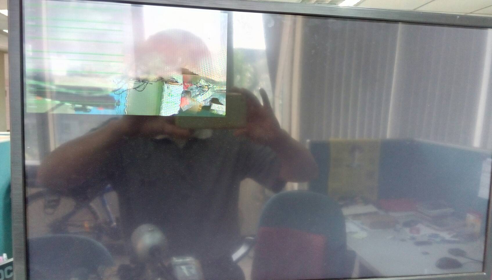

  • Hi Sir
    thanks for your reply.
    After following your instrument to do this experiment in Linux ProcessorSDK (Automotive) 3.02, the status is as below
    1. Camera Input from LVDS Camera 1 to 5 can show on the screen successfully.
    2.  We execute command " dmabuftest -s 32:1920x1280 -d /dev/video1 -c 1280x720@YUYV"
        the video only showed "640x480" on the left-up corner with flicker and  Horizontal stripes.
       this phenomenon is the same with another four LVDS camera input.
    3. If we connect OV camera module with Visionboard, the display is normal
    Do you have any suggestion and thanks
    BR
    Yimin
  • Hello Yimin,
    For the resolution of video not being correct, please check your monitor resolution by running modetest.
    Pass the correct resolution to dmabuftest -s connector:widthxheight
    For the video corruption you see in the LVDS cameras, it's because of the pixel clock not being correct.
    For lossless video transmission, the PCLK used by camera should be around 100Mhz
    Current driver automatically chooses the pclk based on video size.
    You can run following commands to change the PCLK to 96Mhz.
    i2cset -f -y 11 0x30 0x30 0x03 0x20 i
    i2cset -f -y 11 0x30 0x30 0x04 0x03 i
    #Replace i2c bus number 11 to the required bus number.
    You can add this in the driver also if you want this to be done as part of the ov1063x driver.
    Nikhil D
  • Hi Sir
    After trying your method, the result is still failed. and the phenomenon is the same.
    attachment is the log message by using execute "modetest" and "i2cset" command.

    root@dra7xx-evm:~# i2cset -f -y 11 0x30 0x30 0x03 0x20 i
    root@dra7xx-evm:~# i2cset -f -y 11 0x30 0x30 0x04 0x03 i
    root@dra7xx-evm:~# dmabuftest -s 32:1920x1280 -d /dev/video1 -c 1280x720@YUYV
    Opening Display..
    using 1 connectors, 720x400 display, multiplanar: 1
    Opening V4L2..
    Exported buffer fd = 6
    Exported buffer fd = 8
    Exported buffer fd = 10
    Exported buffer fd = 12
    Exported buffer fd = 14
    Exported buffer fd = 16
    ^C
    root@dra7xx-evm:~# i3cset
    -sh: i3cset: command not found
    Usage: i2cset [-f] [-y] [-m MASK] [-r] I2CBUS CHIP-ADDRESS DATA-ADDRESS [VALUE] ... [MODE]
      I2CBUS is an integer or an I2C bus name
      ADDRESS is an integer (0x03 - 0x77)
      MODE is one of:
        c (byte, no value)
        b (byte data, default)
        w (word data)
        i (I2C block data)
        s (SMBus block data)
        Append p for SMBus PEC
    i2cdetect  i2cdump    i2cget     i2cset
    root@dra7xx-evm:~# i2cget
    Usage: i2cget [-f] [-y] I2CBUS CHIP-ADDRESS [DATA-ADDRESS [MODE]]
      MODE is one of:
        b (read byte data, default)
        w (read word data)
        c (write byte/read byte)
    root@dra7xx-evm:~# i2cget -f -y 11 0x30 0x30 0x03
    Error: Invalid mode!
      MODE is one of:
        w (read word data)
    root@dra7xx-evm:~# echo 3 >/sys/class/video4linux/video1/dev_debug
    root@dra7xx-evm:~# echo 3 > /sys/module/ti_vip/parameters/debug

    BTW, if we connect OV10635 module to vision-board directly, the display is normal.
    please advise and thanks.
    BR
    Yimin
  • Hi Yimin,
    The i2c commands are to change the pixel clock of the camera.
    You should run them while the capture is happening.
    By default, the subdev driver automatically configures pixel clock. So you have to change it AFTER the capture is started.
    Note that this is only because of the LVDS link which is there only on the multides boards.
    Directly connected camera does not have any pclk restriction, hence it works well.
    LVDS link needs to have pclk in certain range, that's why you have to change it.
    Nikhil D
