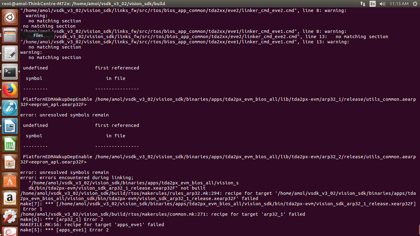

    I have created a wrapper API for eeprom access named "eeprom_api.c" at the path "vision_sdk/links_fw/src/rtos/utils_common/src" and the included its header file at path "vision_sdk/links_fw/src/rtos/utils_common/include"
    The file contains three function APIs as follows:
    1. i2c_eeprom_init()
    2. i2c_Write()
    3. i2c_Read()
    init function API is called in the file "system_common.c" at path "vision_sdk/links_fw/src/rtos/links_common/system" under function "System_initCommon()". "eeprom_api.h" is also included in the "system_common.c" file.
    Write and read function APIs are called in the "iss_capture_isp_simcop_display" usecase file "chains_issIspSimcop_Display.c".

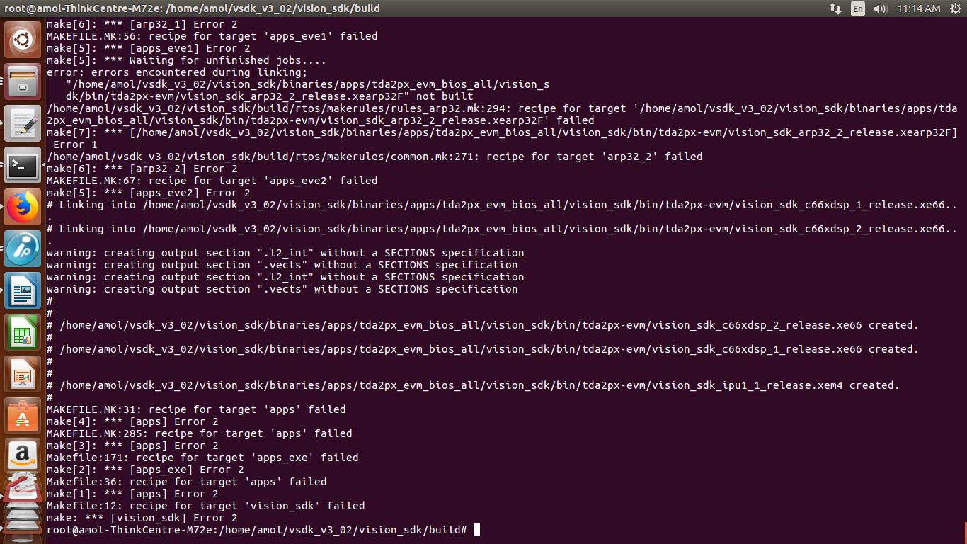

    Now when we compile the vision SDK through command "make -s -j depend" followed by "make -s -j" we get error in linking the API.
    screeshots of error encounterd are attached.
    I am not able to identify where I am going wrong. Could you help me with this issue?
    Rishabh
    This API is defined in pdk.
    As I mentioned in one of the threads previously you can't call these APIs directly in Vision SDK.
    If you face any build issues, you should grep the same in PDK and then write an API in Vision SDK app that does the same for you.
    Rishabh

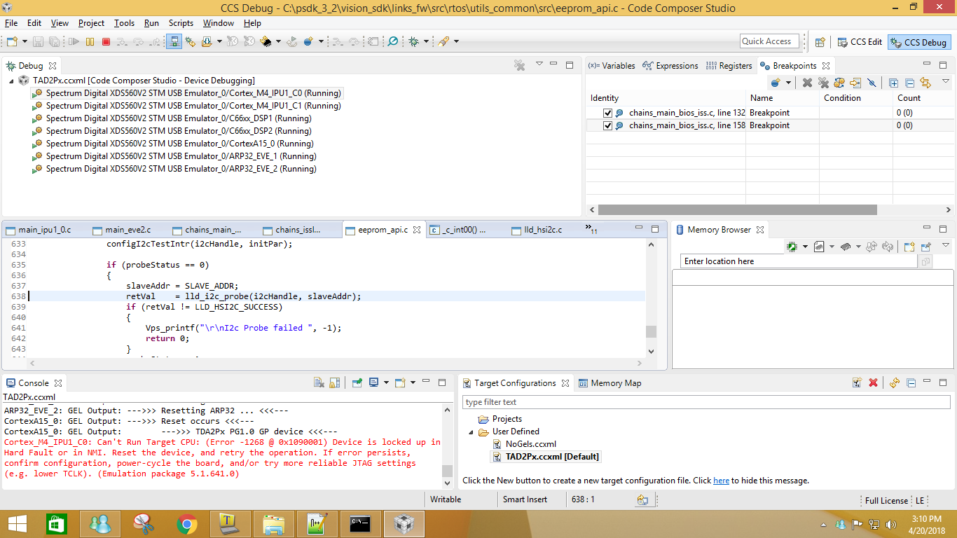

  • Hello Rishabh,
    Thanks for the reply.
    We have separately written an API for "PlatformEDMAWkupDepEnable" and that error has been resolved.
    Now as mentioned in the previous asked query, 'i2c_eeprom_init' API is called in the file "system_common.c" at path "vision_sdk/links_fw/src/rtos/links_common/system" under function "System_initCommon()".
    My eeprom wrapper header file "eeprom_api.h" is also included in the "system_common.c" file.
    "i2c_Write" and "i2c_Read" function APIs are called in the "iss_capture_isp_simcop_display" usecase file "chains_issIspSimcop_Display.c".
    But when we try to run this usecase, it stucks and and did not enter the usecase.
    We debugged it through CCS v6, we get the "Hard fault' at "lld_i2c_probe".
    The screenshot of the error is attached with the issue.
    Could you guide us how to resolve this issue?

    You should do a step into and see where exactly you get a hard fault. As I have told multiple times this is not the efficient way of doing this.
    You will face a lot of issues if you just compile PDK files in Vision SDK especially the one that use shared resources like i2c, EDMA, interrupt, etc.
    Making it work for a single case is quite hard and in the long run you will end up spending lot of time.
    Ideally you should add eeprom functionality to BSP boards and then use it.

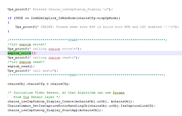

    When we are calling "eeprom_write()" and "eeprom_read()" functions from usecase "iss_capture_isp_simcop_display" from file "chains_issIspSimcop_Display()' in function "Chains_issIspSimcop_Display()"  we are getting data mismatch.
    We are not getting what we are writing to eeprom though both the functionality does not fail.
    We are calling "eeprom_write()" function followed by "eeprom_read()".
    Following is the attached screen shot of the snippet of the function call.
    These APIs then calls read/write functions from out eeprom API which is at path ../vision_sdk/links_fw/src/rtos/utils_common/src.
    We give page address as 1, data length as 48 and EEPROM slave address.
    Can you help me with this.

  • Hii,
    Is there any update on this issue?
     we are giving '10' as page address and device address is '0x50'.
    We are writing a character string, with some random charaters, to the eeprom memory to test. String is like:
    uint8_t dataWriteBuffer[48] = "abcdefghijklm012345678909876543210nopqrstuvwxyz"
    When we read the eeprom we are getting data mismatch though we are giving page address as '10' and device address as '0x50'.
    When we try to read the data from page address '0' we are getting the same data what we get from the function "Bsp_boardGetBaseBoardRevTda2xx()"
    We are debugging through JTAG over CCSv6 and at the memory address which we are reading, we are not getting the data what we are writing.
    So is there any thing we are missing here.
    Please help me with this.
    Rishabh
    You need to see the logic from EEPROM app and provide the same in your EEPROM APIs.
    EEPROM has block size of 64 bytes.
    In order to write you first need to calculate the block address and then you can send 2 address bytes + 64 data bytes in single I2C write API.
    For read you should first write the 2 byte address.
    Then you can read 64 bytes of data in single I2C read API.
