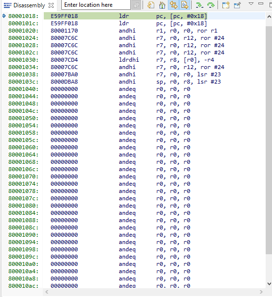

I am working on K2G-EVM board and using Processor SDK RTOS(4.02.00.09). My CCS version is 7.3.0.00019. I have created USB host mode project for arm using pdkProjectCreate.bat file. I have built the USB driver using the below command:
gmake BOARD=evmK2G SOC=k2g CORE=a15_0  BUILD_PROFILE=debug
I am able to put the break point and hit at the break point. But once I click on step in, I get the following error message:
No source available for "0x80001018"
Below is the screenshot of disassembly:
Can you suggest me what am I doing wrong?

  • Krishna,
    As far as I can tell, you are still linking in the release version of the board library as you can see from the text I have highlihgted in your build log :
    generating custom ti.sysbios library makefile ...  Linking with library ti.drv.usb:./lib/k2g/a15/debug/ti.drv.usb.aa15fg Linking with library ti.board:./lib/evmK2G/a15/release/ti.board.aa15fg Linking with library ti.drv.i2c:./lib/k2g/a15/release/ti.drv.i2c.aa15fg Linking with library ti.drv.uart:./lib/k2g/a15/debug/ti.drv.uart.aa15fg Linking with library ti.osal:./lib/tirtos/k2g/a15/release/ti.osal.aa15fg Linking with library ti.csl:./lib/k2g/a15/release/ti.csl.aa15fgStarting build of library sources ...making C:/ti/pdk_k2g_1_0_7/packages/ti/drv/usb/example/bios/src/sysbios/sysbios.aa15fg ...gmake[1]: Entering directory `C:/ti/pdk_k2g_1_0_7/packages/ti/drv/usb/example/bios/src/sysbios'gmake[1]: Nothing to be done for `all'.gmake[1]: Leaving directory `C:/ti/pdk_k2g_1_0_7/packages/ti/drv/usb/example/bios/src/sysbios'Build of libraries done.cla15fg package/cfg/usb_arm_k2g_evm_pa15fg.c ...'Finished building: C:/ti/pdk_k2g_1_0_7/packages/ti/drv/usb/example/bios/usb_arm_k2g_evm.cfg'' 'gmake[1]: Leaving directory
    Can you try adding in the configuration file where the board module is added to the BIOS configuration.
    Board.Settings.libProfile="debug"
    This should be similar to what you have done for the USB driver as I do see that the debug version of the library is being linked to your application.

  • Hi Rahul,
    I added the debug profile for all the packages but it did not help. I am getting same error (No source available for "0x80001018" ) whenever I step in any function; even the address 0x80001018 is same for all the functions. I am able to hit all the break points which I keep, just not able to step in after that.

    Krishna
    I was able to solve my problem by adding the PDK directory in Run-> Debug Configurations-> CCS -Device Debugging-> <Project Name> -> Source (Device selected as Cortex A15 in source tab).
