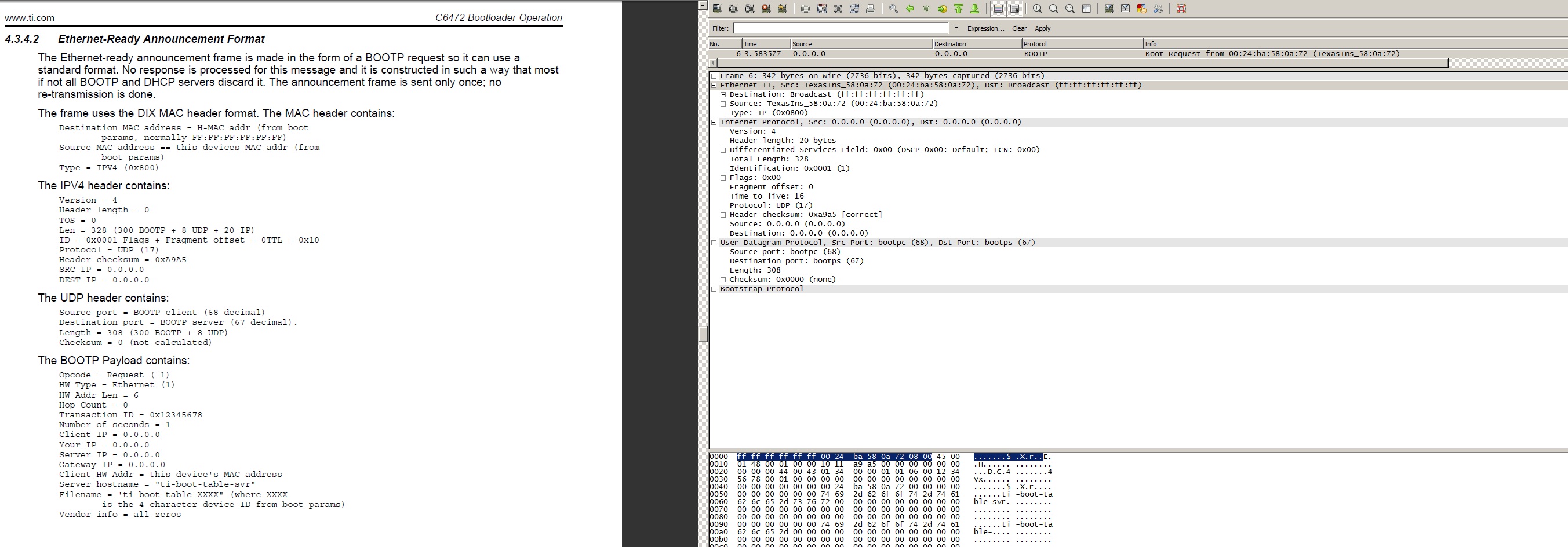

I am able to get the 6474evm to generate a BOOTP packet.  However, I am finding it difficult to actually read the packet.  Using windows sockets and lwIP TCP/IP stack I find that the BOOTP packet doesn't make it through the stack.  I can see it on a packet sniffer but would like to boot the DSP by responding to the packet.
I believe the packet is not making it through the TCP/IP stack because the source and destination IP are 0.0.0.0.  I have 2 questions.  Is there a way to change the source and destination IP address for the BOOTP packet(reviewing documenation I haven't found a way)?  If not what recommendations does TI have to handle this packet?
