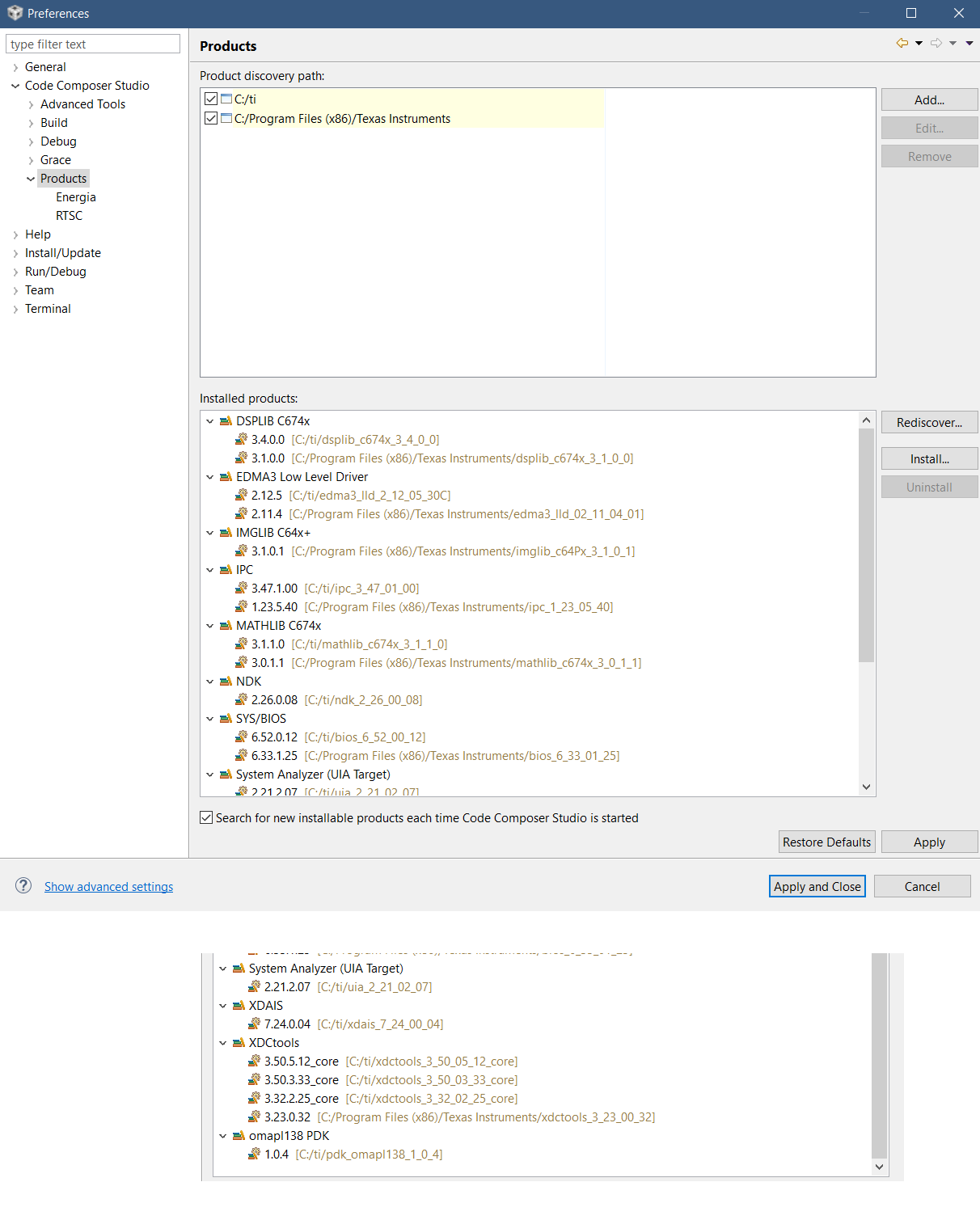

    This is my ti-folder:
    Notwithstanding the above, which is the right example to test the plackback funtionality? In the article you mentioned, there is the example "AIC31 Stereo loopback" which seems to be perfect for this, but for this project I only can find source code for 'evmOMAPL137' (C:\ti\pdk_omapl138_1_0_4\packages\ti\drv\mcasp\example\evmOMAPL137\AIC31_Stereo_Loopback). Is it also compatible with the LCDK?

    I cannot identify the problem. The PDK_SHORT_NAME should be right... So which path is not set correctly?
    Kind Regards,
    Patrick

  • Hi Sahin,
    I tried it again, but it's always the same result. Something is missing.
    The output from the command line:

    One thing I notice is that the library IMGLIB didn't come with the SDK. Do I need this? I'm only want to do audio projects, but "pdksetupbv" has linked to "C:/ti/imglib_c674x_3_1_1_0" which is missing.
    These is my "pdksetupenv.bat" and "pdkProjectCreate.bat":

    All version numbers should match. In the bat file I have changed EMDA_VERSION from "edma3_lld_2_12_05_30B" to "edma3_lld_2_12_05_30C", but the problem still exists.
    As I had installed the SDK, CCS installed the packages. Here are my CCS preferences (the installations under "C:/Program Files (x86)/Texas Instruments" are from "bios_c6sdk" / starterware) :
    Patrick
