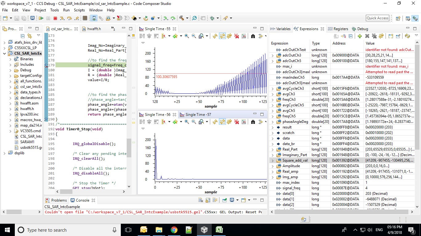

and i want to calculate frequency of the signal..actual frequency is 60Hz ..i set the sample rate=512Hz , and 128poin FFT so accordingly i should get an maximum amplitude at 15 bin but in both the scaling and nonscaling process i am getting it at Bin 1...??
that means frequncy is only 4Hz but that completely wrong..i really dont understand whats going wrong???

  • Hi Kanchan,
    Prove to yourself that you are using the expected sampling rate. The SAR ADC requires 32 SAR clocks to perform one conversion.
    Whenever you perform a SAR conversion, toggle the XF pin or some GPIO. Then measure the frequency of the pin - if you toggle it every time you sample, then the frequency of the pin will be half of the sampling rate. You can use asm(" BSET XF") and asm(" BCLR XF") to toggle the XF pin of the DSP high and low (assumes your project is set to use mnemonic assembly)
    If you are taking data from the SAR ADC, then there will be a DC offset unless you convert the numbers from the range [0 to 1023] to a 2's complement fractional number in the range [-1.0 to 0.999].
    If your input signal is centered about SAR VDD_REF / 2, then the values from 0 to 511 should map to a negative number.
    Keep in mind that the FFT is expectng to see real and imaginary numbers interleaved 16-bit Real, 16-bit Imag, ... SAR ADC will only provide real numbers. You would have to use software to to copy the real part from the SAR ADC into the Real parts of the Real,Imaginary interleaved buffer. All Imaginary parts will be zero.
    It is easiest for me to read the numbers as hexadecimal. Then you can tell if the MSB of the number is set to 1 that that 2's complement number is negative.
    You can also graph the array and the graphing tool will map the 2's complement numbers to the [-1 to 0.9999] range for you. See the below graph configuration. it defines the number as 16-bit signed, with 15 quotient bits. The Index Increment is set to 2 to skip over the imaginary parts. The invec shown here is a 512 long sine wave centered about 0 (in 2's complement).
    Hope this helps,
