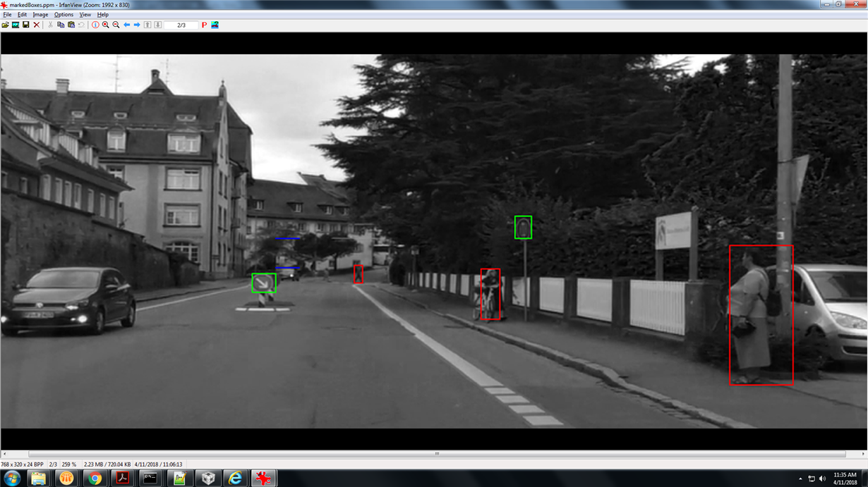

    3)I'm attaching the output bin file(changed the extension to .lib). One of the bounding boxes values is wrong. It's ymax is less than ymin and Is classified as 3 with a confidence of 0.7. it is marked as blue in the image attached. Can you please confirm whether the output is correct. Because I do not have a reference bin file for this.

    The output (stats_tool_out_eve.lib) you attached in previous post looks correct and I used the same for visualisation. See below screenshot for your reference. So, looks like there is some problem in your visualisation tool. Please check.
    Thanks, Praveen

    I feel its right because it works for all others except for vehicle detection values.
  • Hi Praveen,
    I fixed it. I was reading the bin file in text mode on windows, hence it was hitting a early EOF. I opened it in binary mode and now it runs fine.
    Thank you
