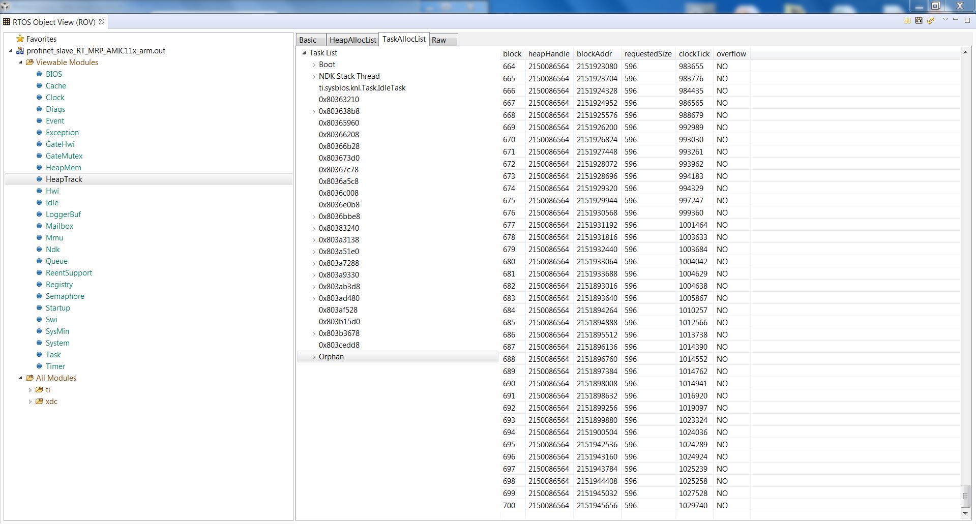

    It looks like, that I have indeed a leak of memory. When the webpage gets recalled every 5 seconds, the totalFreeSize in HeapMem in ROV gets less and less. When I close the webpage in my browser, this totalFreeSize stays the same.
    After ca. 30 minutes I get the following messages:
    "CortxA8: Unhandled ADP_Stopped exception 0x20023"
    And the lagestFreeSize is almost zero:

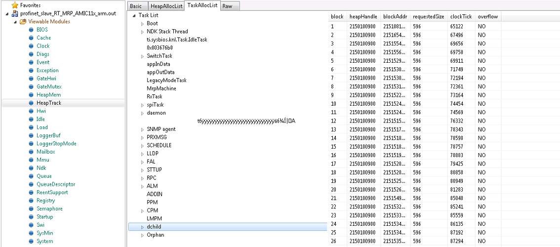

  • Hi Garrett,
    so it looks like if have a Orphan Task Problem.
    I didn't run it for 30 minutes. But after 5 minutes I see already, that in the HeapTrack -> Orphan there are coming more and more blocks.
    But I don't call or exit any task. So how is this possible?

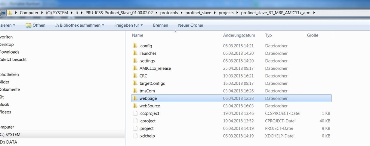

  • I am not able to build your project - fatal error: webSource/webpage.h: No such file or directory.
    Do you have these files in separate folder and not archived in your PRU-ICSS-Profinet_Slave_01.00.02.02.zipfile? From the project build repository and include directories, I don't see anything other than default Profinet ones though.
    #include "webSource/webpage.h"
    #include "tmsCom/spiStructs.h"
    #include "CRC/myCrc.h"
    Garrett
  • On this path should be everything included:
  • OK, I directly imported your project and am able to build it now.
    The profinet_slave_RT_MRP_AMIC11x_arm.txt in ccsproject_args\ is not updated, and I re-created the project with the projectCreate.bat script, so these folders in the profinet_slave_RT_MRP_AMIC11x_arm were lost.

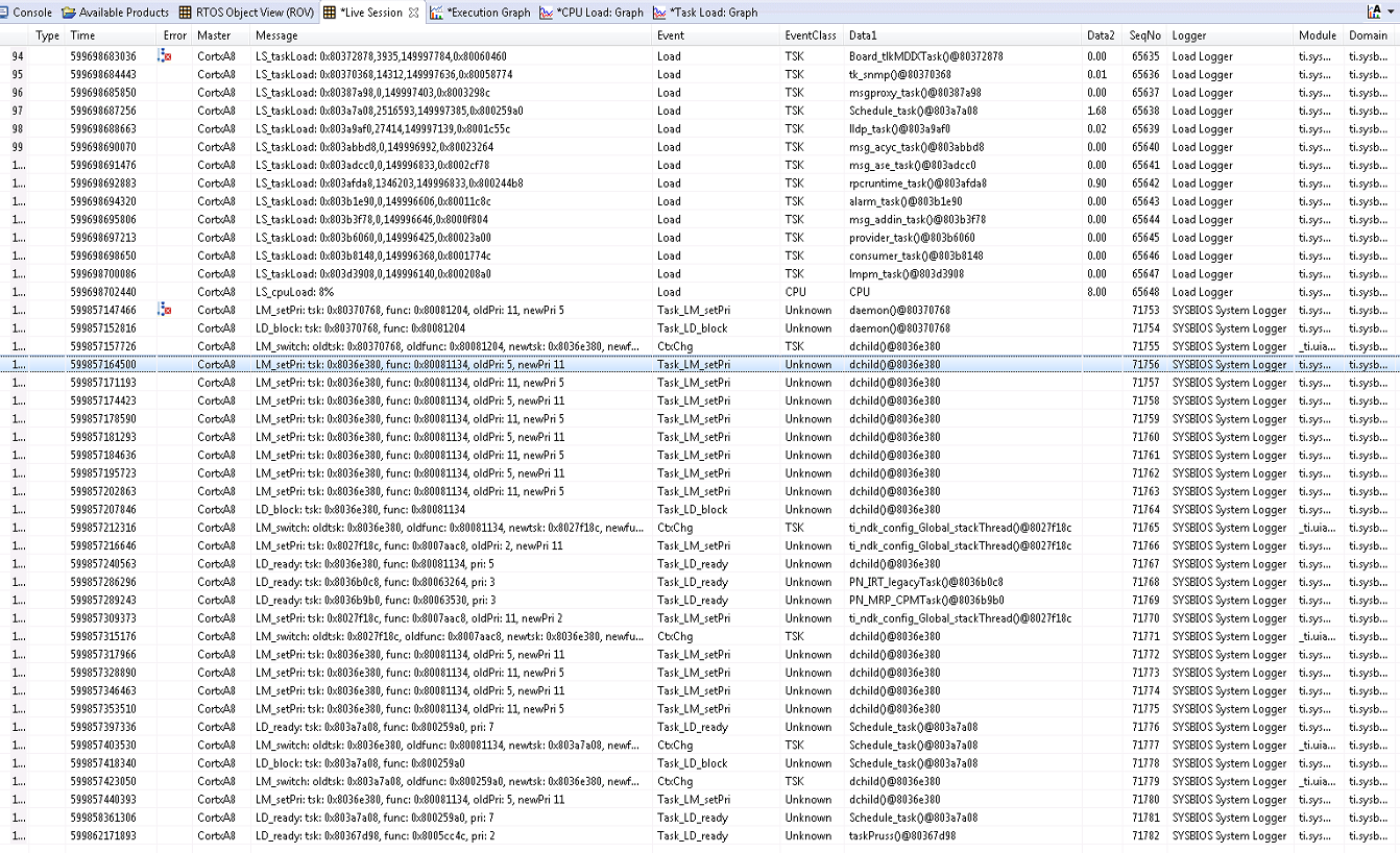

  • I can reproduce the task orphan issue here. The requested heap size is always fixed 596 bytes and appears to be from daemon child (dchild) thread. There was some discussion in the thread regarding the memory release and dchild thread. It looks like adding Task_sleep( ) or adjusting task priority may able to resolve the issue.
    Below is the log from live session and ROV which shows multiple dchild threads:
    Garrett
