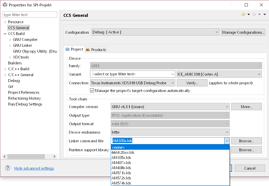

    On further analysis it appears your project contains AM335x.lds which seems to be used in the link step to determine what section gets placed at 0x8000_0000. This file conflicts the following in your .cfg.
    // C-Einstiegspunkt (Startadresse im Speicher)
    Program.sectMap[".c_int00"] = new Program.SectionSpec ();
    Program.sectMap[".c_int00"].loadAddress = 0x80000000;
    What is the reason that you are including this file in your project. I compared the file with the default AM335x.lds packaged with CCS and the contents are exactly the same. If you remove the .lds file or exclude it from the build then the entry point is properly placed at 0x8000_0000.
    There are multiple ways of removing the AM335x.lds file. I am providing some screenshots of ways to do it in CCS.
    After you rebuild the project ensure that he symbol is cinit00 is located at 0x80000000. You can also compare this to the map file from the default Profinet binary to make sure this is aligned.
    Hope this helps.

  • Hi Rahul,
    thank you VERY much! I don’t know why or how we included that file into the project, guess I either copied that from another example or I included it at trying to resolve some linker issue, as checking “AM335x linker command file” sounds right from a user perspective, when you have linker errors and use a AM335x processor. We didn’t know that we must not do that.
