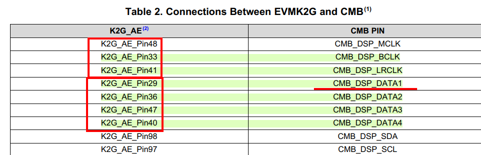

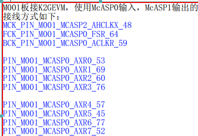

On hardware. we made some changes on connections,as follows:
instead of TI provide infomation:
 But when test . there are some errors . Log from console is as follow:

    we found that  solution here is in the  eDmaConfig( ) ,we should added  as  follows:
    add   Enabling the dmaChannel MCASP0 Events to EDMACC0 (24 & 25)
    EDMA eDmaConfig()
    EDMA3_DRV_Result edmaResult = 0;
        uint32_t temp;
       // uint32_t temp0 ;
    #if    1
        /* Enabling the dmaChannel MCASP1 Events to EDMACC1 (48 & 49) and
         *  Enabling the dmaChannel MCASP2 Events to EDMACC1 (50 & 51)  */
           temp=sampleEdma3GblCfgParams[1].dmaChannelHwEvtMap[1];
           sampleEdma3GblCfgParams[1].dmaChannelHwEvtMap[1]= temp | 0x000F0000;
        /* Enabling the dmaChannel MCASP0 Events to EDMACC0 (24 & 25)   */
           temp=sampleEdma3GblCfgParams[0].dmaChannelHwEvtMap[0];
           sampleEdma3GblCfgParams[0].dmaChannelHwEvtMap[0]= temp | 0x03000000;
    #else
        /* Enabling the dmaChannel MCASP2 Events to EDMACC1 (50 & 51) */
           sampleEdma3GblCfgParams[1].dmaChannelHwEvtMap[1]= temp | 0x000C0000;
    #endif
    /* Initialize eDMA 0 */
        hEdma0 = edma3init(CSL_EDMACC_0, &edmaResult);
        if((hEdma0 == NULL) || (edmaResult != 0))
        IFPRINT(cmb_write("eDMA instance 0 Initialization Failed\n"));
        IFPRINT(UART_printf("eDMA instance 0 Initialization Failed\n"));
        return (Cmb_EFAIL);
    /* Initialize eDMA 1 */
        hEdma1 = edma3init(CSL_EDMACC_1, &edmaResult);
        if((hEdma1 == NULL) || (edmaResult != 0))
        IFPRINT(cmb_write("eDMA instance 1 Initialization Failed\n"));
        IFPRINT(UART_printf("eDMA instance 1 Initialization Failed\n"));
        return (Cmb_EFAIL);
     The  error dispears ;
