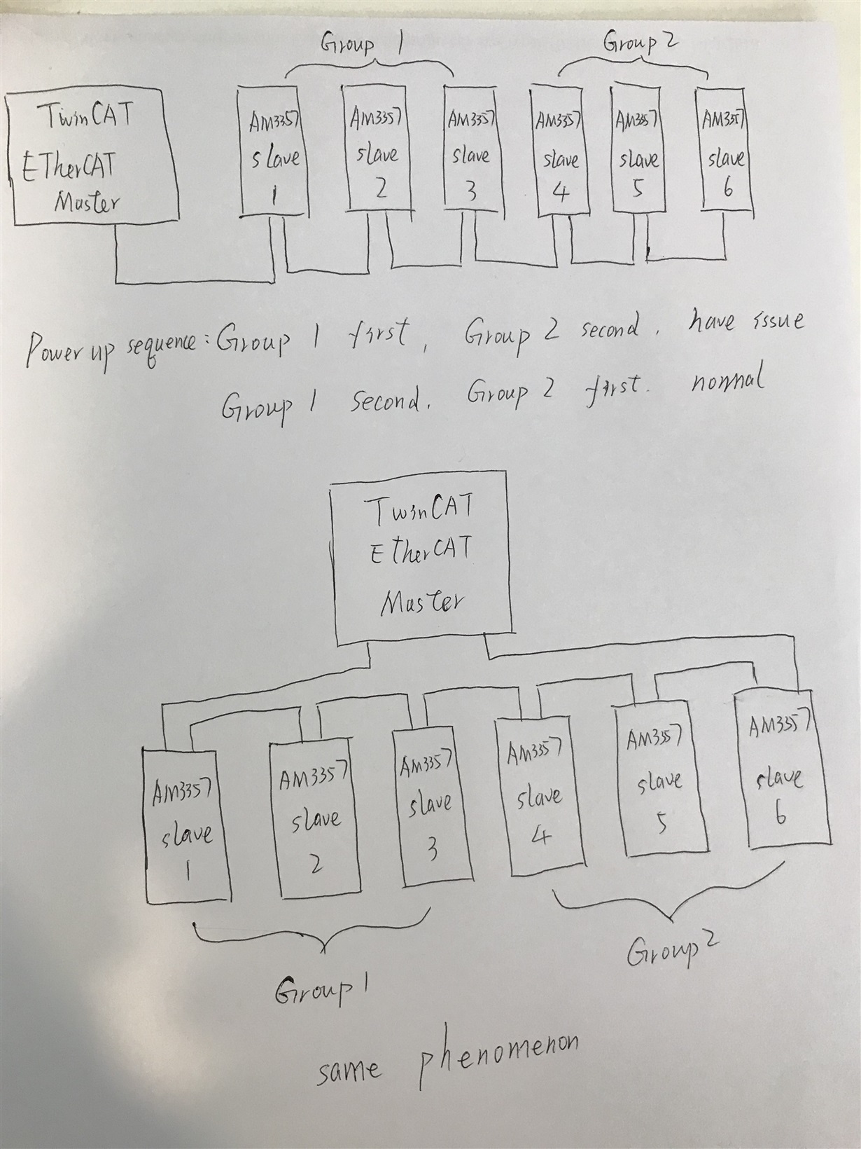

Hi EtherCAT slave expert:
My customer use AM3357 for EtherCAT slave product, now they find that AM3357 should have EtherCAT initialization failure issue in terms of device power up sequence, both in line topology and circle topology, please see the below description by picture.
Could you please test it by AM3359 ICE board?

    We can set up the topology and run the test on AM3359 ICE v2 board. In the meantime, can you elaborate the ' EtherCAT initialization failure issue'? Is the TwinCAT not able to detect all the slave boards? And does it fail intermittently or always? And when it fails, which status is the EtherCAT slave in?

    TwinCAT can detect all the slave boards in the failure case, in the power up sequence which lead to failure, the error will occur every time.
    The failure status has 2 situation, one is CRC error on port B, another is no data communication on port B.

    Do you check the CRC error from EtherCAT Rx error counter register 0x300-0x307 and data communication from DL status register 0x110-0x111? Given the CRC error, it's more likely a hardware issue on the custom AM3357 boards. The test result on AM3359 ICE board may not be meaningful but I have requested testing team to provide for confirmation. Some additional info may help:
