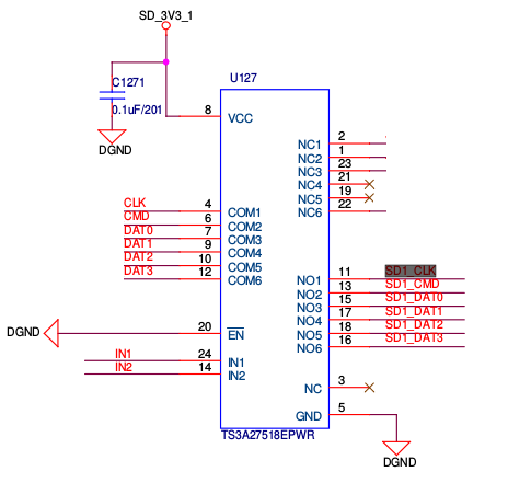

I am working on a custom board with AM5716 based CPU variant.
I have MMC1(SDR104) controller of AM571x connected to TS3A27518EPWR MUX (NO1-NO6 lines, schematics below). Mux selection lines are controlled to chose the input source as MMC.
I am able to boot MMC card Class-4.
I am seeing issue with UHS-cards, failing to switch to 1.8V and ending with SD error initialization, below is the log.
I have verified that controller HCTL & AC12 are properly configured to 1.8V and PMIC is also setting VSDMMC to 1.8V
Our custom board design is as per AM571x-IDK, I have used kernel prints to get the sequence.

I observed that voltage at R226, R227 is 2.54V instead of 1.8V, what  could be the reason, here is part of the schematics
