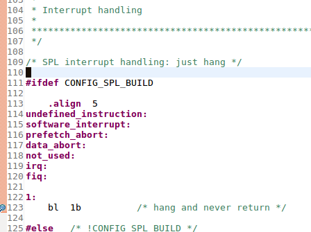

We have custom boards based on the BeagleBone Black AM3358.  We appear to be experiencing DDR3 boot issues in that we never make it out of the Secondary Program Loader (SPL).  We are able to JTAG via an XDS200.  However, we will seemingly & randomly be vectoring to the following snippet of code in vectors.S:

  • I wanted to quickly followup on the root cause of our problem before anyone spent too much time looking into this issue.
    Turns out our issue was related to a board identification problem. On our custom board we did not populate the i2c eeprom part as in the BBB. When we were debugging the BBB we mistakenly believed the BBB was identifying itself as the ICE board (different Industrial Communication Engine am335x board). So, we set our board to look like the ICE board in the u-boot board.c. Once we changed our identification to match the BBB, which was/is AM335BNLT (for bone light?), our memory was fine and we are now booting past u-boot and into the kernel!
