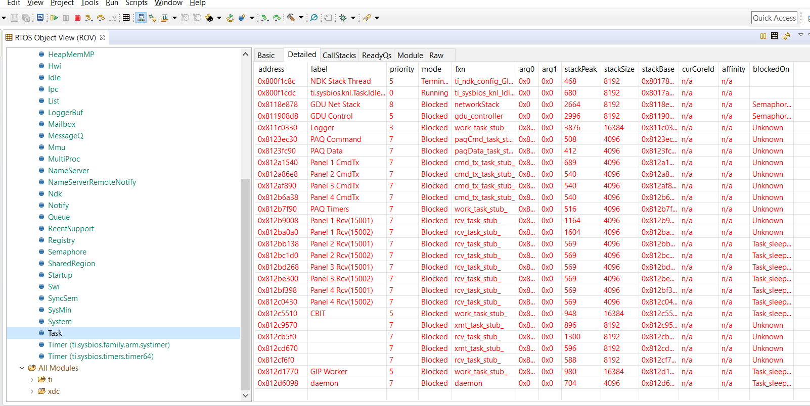

    Since your _ipcfg object is never getting updated, I'm wondering how many tasks you have and their respective priorities. Use the ROV view to inspect your tasks. Note their priority. Your application task should be lower than the network tasks.

    I have a lot of sockets with sets connected to the same EVM. (I am connecting to 4 EVM servers, each with up to three sockets). So watching these tcps values shows me what, the aggregate?
  • Ramsey,
    Thanks for the continued assistance. I’m still not clear on _ipcfg.TcpKeepIdle as a data object, not code. I made the watchpoint as you instructed, and it still was not ‘hit’.
    I also set the same watchpoint on the server side and it wasn’t hit on that application either. That application is only running 3 sockets (verses the 3x4 + 2 where I'm connecting to four servers each with up to three ports and is also providing two server ports).
    The comment about ‘how many tasks’ deeply concerns me. Is there some hard or practical limit that I am not aware of? I am in for a major redesign if that is the case. As far as priorities I need to go back and revisit that. I’ve got another thread going on that topic and I still am not clear. (ref: e2e.ti.com/.../2518565 . Right now my Network stack task is at priority 8, and the socket tasks are at 7 as are many other tasks that are not dealing with socket comms. ROV task screen capture below for reference.

    Looking at your ROV screen shot, I can see that NDK task has terminated. Since you never observe _ipcfg getting updated, I'm guessing the NDK task terminated before it had a chance to spawn the boot task which would have updated _ipcfg. I also see GDU Net Stack and GNU Control. Are these your tasks or some other networking tasks?
    At this point, we need to figure out why the NDK task is terminating. The NDK User Guide, Section 3.5.2 Controlling Debug Messages gives some information on how to instrument the NDK code. This would be a good place to start.

  • Well I'm getting more confused....
    "Looking at your ROV screen shot, I can see that NDK task has terminated." "At this point, we need to figure out why the NDK task is terminating."
    The task has always shown as terminated. I start with the NDK example: NIMU_emacExample_EVMK2H_armBiosExampleProject
    I just reloaded that unaltered example, ran it and then hit suspend. Attached is the ROV screen capture with the Tasks displayed and it is showing that the NDK Stack is terminated. I always assumed that was therefor normal.
    Mike

    My mistake. I have come to learn that the examples in the Processor SDK do not use the NDK task but provide their own. The NDK task is still invoked but all it does is start the NDK heart beat and then terminates. This is enabled with the following configuration code:
    var Global = xdc.useModule('ti.ndk.config.Global');
    Global.enableCodeGeneration = false;
    Now, a side-effect of doing this is that it disables most other configuration code, including the Tcp configuration we have been discussing. This explains why you are never seeing the Tcp keep alive values applied to the _ipcfg object.
    When using this approach, it becomes the responsibility of the networkStack task to apply the Tcp configuration using C code. Please add the following code to this task:

    Finally, I see that most of the stack (8KB) for the terminated NDK task was never used. This memory is essentially wasted. If you want to minimize the memory usage, you could reduce the NDK task stack size to about 0x200. You must still do this using the configuration script (more confusion):
    Global.ndkThreadStackSize = 0x200;
    I hope this clears up the confusion and explains the behavior your have been observing with the keep alive feature.
