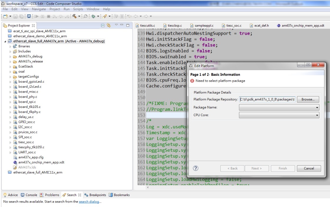

I'm setting AM437x DDR-Less System with PRU SDK. (PRU-ICSS-EtherCAT-Slave 01.00.05.00)
How to open the following windows in CCS7.

Hi will in CCS debug you can find View/Edit platforms in RTSC tools.

Hi, please browse to your <SYSBIOS_version_path>\packages, pic your board packager and press next. An example is shown below:
Just, for your reference, this is explained in a nice presentation, done by one of my colleagues (slide 60):
There are also other nice videos there in case you want to check them.

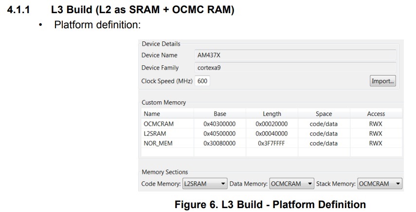

When I finish this setting, where can I find the .cfg and .xdt file?
Are it fit to my new setting?
Hi Evan, after you modify/save your new platform you can used in your CCS project. Properties -> General -> Platform.
About .cfg file, this comes along with EtherCAT slave project. It should have a name like "am335x_app.cfg" or "ecat_appl.cfg". About .xdt, in case of our previous Industrial SDK (ISDK), which was the SDK used for mentioned above AM437x DDR-less application note, you can find it at "/protocols/ethercat_slave/ecat_appl/ecat_appl.xdt";"

Thanks for your respond, but there is no "ecat_appl.xdt" file in my folder. It's only has "amic11x_onchip_mem_app.xdt", and my platform is "AM437x".
Hi Evan, please note DDR-less application note was developed and validated with Industrial SDK (ISDK) .
ISDK was replaced last year by PSDK + PRU-ICSS EtherCAT industrial software add-on. So, this application note should be used as a general guidance of what needs to be done, but, because it wasn't created (nor validated) with the new software PSDK package, then, some things, and names might be different..
