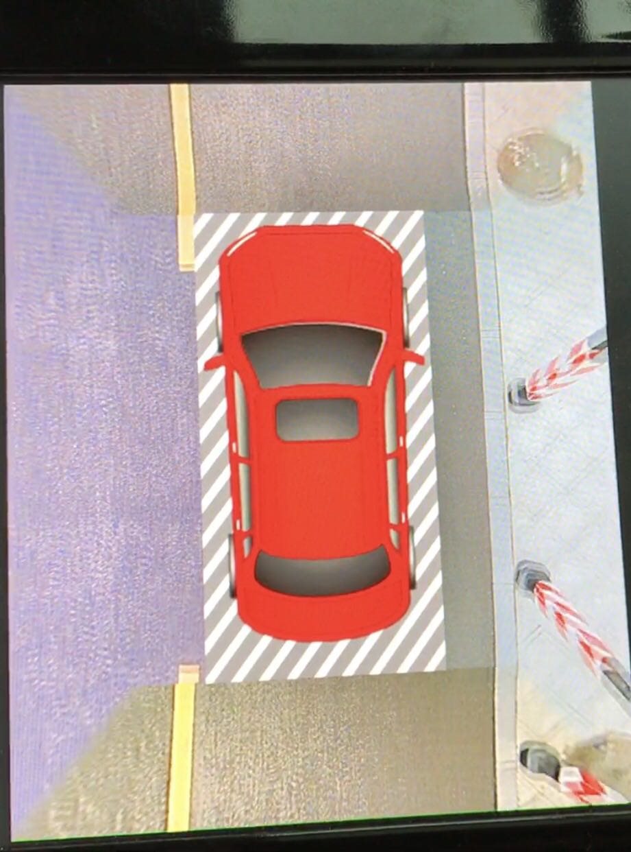

  I am working on the 2D SRV, and got a display result as follows:
  as you see, the geometric alignment is OK, but the photometric alignment is not good. There is a obvious difference on color and brightness between two adjacent views.
  So my question is how to improve this? And are there any ways to set the 4 views's color, brightness and white balance to the same value? Then the whole view will look like as if it were
taken by a single camera.

  • Hi Suryamani
    I used our own custom board based on TDA2Ex, with CSI2 camera interface. (usecase: rtos\usecases\csi2_cal_sv_standalone)
    Yes, i have done the calibration. As you see the image in my post, the geometric alignment is good which means the calibration is successful.
    But i think the calibration can only solve the problem of geometric alignment. Now my issue is photometric alignment with obvious difference on color and brightness. (This problem is more serious when i tested it outdoor)
    xuanbo

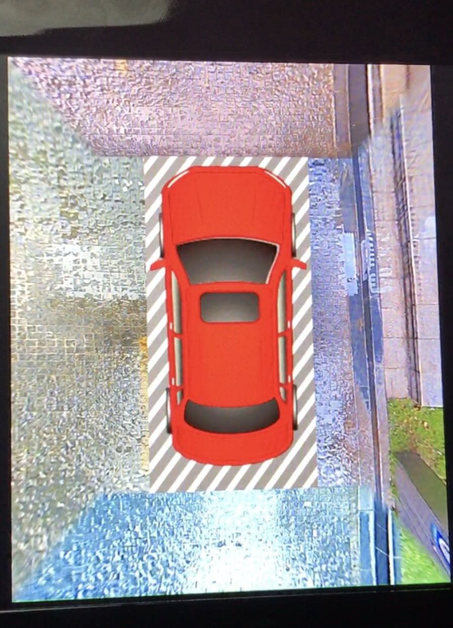

  • This is the test result at outdoor:

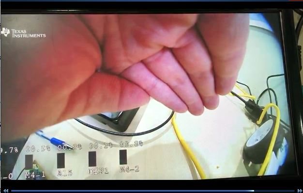

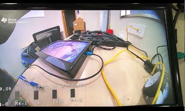

  • Hi Luke
       And i also test the camera at bright/dark light source: (Image come from ISSCapture)
       Bright light source:
       Dark light source:
        As you see, when the light source is changed to dark, the image captured by camera sensor become brighter.

  • Hi Xuanbo,
    Seems like AE is functional, can you ensure same lens module is used for all cameras?
    Also, check if there are minutes gaps between the lens mount and sensor board.
    Sujith
