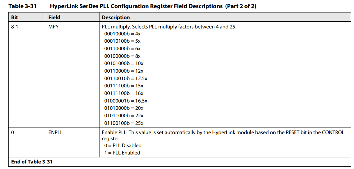

Dear Sirs,
I have a problem from HyperLink MPY factor selection.
In datasheet page, I know that I can use the equation to choose the desire MPY factor.
PLL_OUTPUT=REFCLK*MPY
And the MPY magnification value need to setting between 4x-25x in datasheet page,as :
PLL multiply. Selects PLL multiply factors between 4 and 25.
00010000b = 4x
00010100b = 5x
00110000b = 6x
00100000b = 8x
00101000b = 10x
00110000b = 12x
00110010b = 12.5x
00111100b = 15x
00111100b = 16x
01000001b = 16.5x
01010000b = 20x
01011000b = 22x
01100100b = 25x
I want to know the relation and regulation between MPY register setting value and the magnification value.
And why when set magnification=15x & 16x, the MPY has the same register value?
Yvonne.lu
  • The team is notified. They will post their feedback directly here.
    BR
    Tsvetolin Shulev
    That is a typo. For typical usage, you can select the MPY based on the Table 2-6 Example Operating Rate Configurations of the Hyperlink user guide, 16x should be 01000000b.
    Regards, Eric

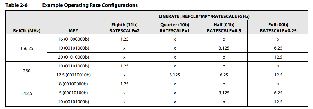

  • Hi Iding,
    The Example Operating Rate Table is another problem~
    If I use RefClk=312.5MHz  MPY=5 Output PLL= 1.5625GHz , at this table means I can't use the Quarter and Eighth RateScale ?
    Because I saw that some blocks typed 'x'.
    If I want to adjust MPY to multiply Output PLL=1.5625GHz (RefClk=312.5MHz ) to 5.3125GHz, at Table3-31 mean I can't choose the 17x MPY ?
    But Table 3-31 tells that PLL MPY could selet between 4 and 25.
    Yvonne.lu
    The input clock can be:
    156.25 Mhz
    • 250 MHz
    • 312 MHz
    The MPY field can be programmed to several values; however, the PLL_OUTPUT
    value must be in the 1.5625 GHz to 3.125 GHz range.
    The Hyperlink typical runs for 3.125G, 6.25G and 10G. Please let me know what is your intended baud rate for Hyperlink?
    If I use RefClk=312.5MHz MPY=5 Output PLL= 1.5625GHz , at this table means I can't use the Quarter and Eighth RateScale ? =====> running at that low speed is meaningless for such a high speed interface.
    If I want to adjust MPY to multiply Output PLL=1.5625GHz (RefClk=312.5MHz ) to 5.3125GHz, =====>PLL_OUTPUT
    Point is typical customer runs at 3.125G, 6.25G and 10G., you can select the MPY based on your input clock to get that speed.
    Due to Silicon errata, Advisory 21 HyperLink Data Rate Limited to 40 Gbaud Issue, you can't run 12.5G.
    Regards, Eric
